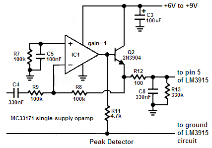

The circuit is a "peak detector". Your vision sees normal brightness when a light is turned on for 30ms or longer. Shorter durations are seen as dimmed. The peak detector holds the peak voltage for a moment that is 30ms in duration so you can see it brightly. Then it decays fairly quickly when the signal is gone.
Simple VU meters without a peak detector have the lower voltage LEDs lighted almost all the time but the higher voltage LEDs can barely be seen because they are very dim.
I used the MC3317x opamps because their slew rate allows a max frequency of 35kHz (an LM324 or LM358 is similar but has a low slew rate which allows a max frequency of only 2kHz).

Thanks for explaining the purpose. How do you adjust the gain?
What voltage do you suggest running the LM3915 at? Is there a way to run your peak detector circuit and the LM3915 from the same source?
The gain can be adjusted by the signal source. The peak detector is fed from a preamp opamp that also can have variable gain or have an input volume control.

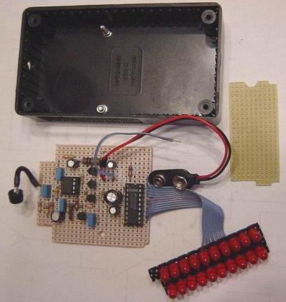

In my Sound Level Indicator project I have a mic preamp (gain is 101) driving the peak detector (gain is 1.8) and have an automatic gain adjustment that reduces the gain 10 times when loud sounds are detected. It shows a pin dropped on the floor in the next room or shows very loud sounds from the stereo or TV.

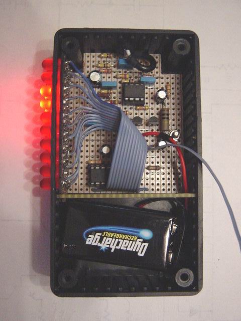

My project is powered by a "9V" (actually 8.4V) Ni-MH battery that is always trickle charged to 10V. The electret mic and bias for the preamp is powered from a 5V low-dropout voltage regulator IC that also provides a DC reference voltage to the automatic gain circuit.
Each output of the LM3915 has two 1.8V red LEDs in series and their current is set to about 26mA. I connected a 10 ohm/1W resistor in series with all the LEDs so it dissipates 0.68W when all LEDs are lighted.

Thanks Guru. So it should be OK to run the LM3915 from a 9V source then?
What would be the preferred method to adjust the gain then? I'm not sure how it auto adjusts, is that the job of the transistor? I'm unsure how to adjust the gain of the Op-amp.
Just to check, the audio line signal goes into C4?
Many thanks
Thanks Guru. So it should be OK to run the LM3915 from a 9V source then?9/quote]
The pin 7 reference voltage must be 1.5V (or more) less than the supply voltage. The schematic in the datasheet has a 10V reference so it uses a 12V supply. The LM3915 will operate from a supply as low as 3V if the reference is set to 1.25V to 1.5V and the input signal max peak voltage is the same.
What would be the preferred method to adjust the gain then? I'm unsure how to adjust the gain of the Op-amp.
The gain of the opamp is the ratio of R8/R9. If the value of R9 is reduced then the value of C4 must be increased to maintain low frequency sensitivity.
Yes. In my project it is driven from the output of my mic preamp.
In your circuit the output of an ipod or MP3 player will not be high enough without adding some gain.
Connect a volume control to the input of C4 if you want.

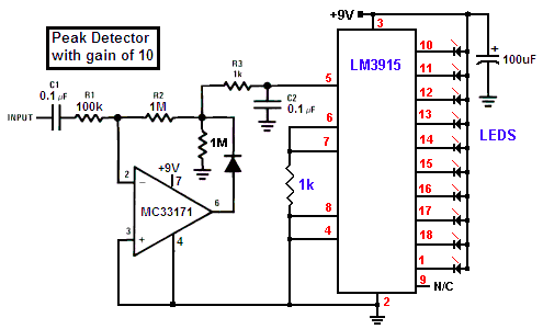

Just been searching through more LM3915 posts on here. I have found the circuit attached that I think you posted somewhere. I looks quite a bit more simple, would you mind explaining the differences between it and the circuit you have been helping me with?
The transistor charges the timing capacitor 10 times to 20 times faster so you see every short duration sound displayed on the LEDs. The diode circuit does not display short duration sounds.
