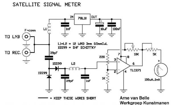

Hi
I"m looking for the schematic diagram of a satellite signal meter. I know that there are cheap meters, but I would like to build one.
Thanks.
Here's you are,
I just found it in my PC, so I do not know the original base for it, Maybe somebody can help for the origin website!
Good luck.
