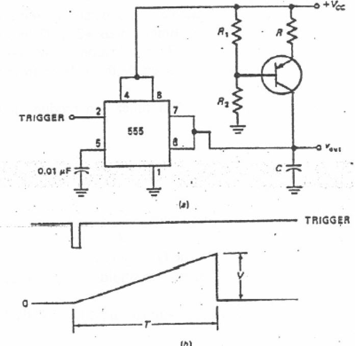

I appreciate your responses. I tried the previous circuits provided but as you all know they are not a very good sawtooth generator. However, I am exploring the one below. It is good up to 20k Hz but beyond that point the signal dies completely out. I will keep on working on it. Any help will be highly appreciated.

Hi there,
How accurate do you need this thing? That's a major part of the decision on
what kind of circuit can be used. If you are not sure, perhaps you can tell
us about your intended application and we can recommend something.
For example, a 555 timer ic with a transistor connected as a constant current
generator that charges a cap can be used to some degree.
if you want a slower perfect saw tooth you could try "synthesizing" it with a pic, but being a digital representation of an anlog waveform the clock speed to analog frequency ration will be high: running a pic at 20 MHz might do it at it would give you 40 steps in your half a MHz output, I did this when fooling around but was running at 8 MHz and did not get above 10 KHz in my experiments, I used the PWM output.
another way is to have an DAC and use a counter IC so you can make the counter count from 0 to whatever (depends on your idea of perfection) and the digital to analog converter will output the rising voltage until at the top it will go straight back to 0 and start counting again, I think using a low pass filter output and 4-6 bits of resolution you will get about as near perfect as practicl and possible without having an over complex circuit.
what do you need this for ?

If you are just using the sawtooth to generate a PWM, then it doesn't have to be perfect. A 555 and comparator will give you a great variable PWM output.
I agree. Another option is to take the signal directly off the timing capacitor. Yeah, it's a little crooked, but still a pretty good approximation.

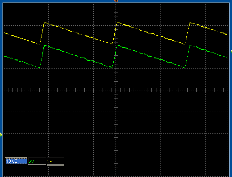

I also said that if you charge a cap with a constant current you would get a flat ramp instead of the rc time constant ramp, not so sure now, I know I have in the past but I couldn't do it today. I put a resistor in the circuit and measured the amps and took a picture of it, then replaced the resistor with a 3 terminal current regulator LM334 and adjusted it to the same current and took another picture, put the on the same picture, attached.
Kinarfi
figured out why I wasn't getting a nice straight ramp, I was using the AC coupling tracer instead of the DC coupled tracer. I use current regulated cap charge ramps fairly often and get nice straight ramps.
here's and example,
