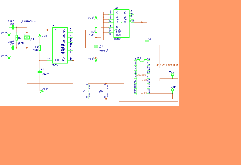

Apologies for not uploading the schematic. I was trying to draw it again ( dont have a scanner handy).
I am uploading the 60Hz-circuit.gif file.
I have tried following too
-- Instead of C5, i have used a low pass filter, It did not help
-- I was slightly confused with using the Vdd/Vss from 8560 and reverse connecting it to Vdd/Vss of the CD4XXX circuit, so I tried to use a separate power supply for the CD4XXX and to be on the safer side, used a optoisolator MCT2E to couple 60Hz signal so that i am sure the powersupplies are totally isolate. But that did not help too !!
I think the problem is now related to the multiplexing of the LED's. continous counting may be that I am using a 60Hz timing reference, but the IC is wired to use the 50Hz from the transformer to multiplexing the LEDs. (This is what even some of the google groups posting replies indicate toooo)

Thanks for posting your circuit, now we can see what you are doing.
Several points are immediately obvious.
1. The counters are being reset after the delays due to C1/R1 & C2/R2. As I told you in a previous post, you don't need to reset the counters in this case since you are using them as frequency dividers. Connect the reset pins on both counters to Vss.
2. I don't understand why you have reversed Vss and Vdd for the SC8560. But I have not looked at its data sheet yet. Don't have one. I'll download one later.
3. You have capacitively coupled the SC8560 via C5 but do not have a pull down resistor on SC8560/pin 25.

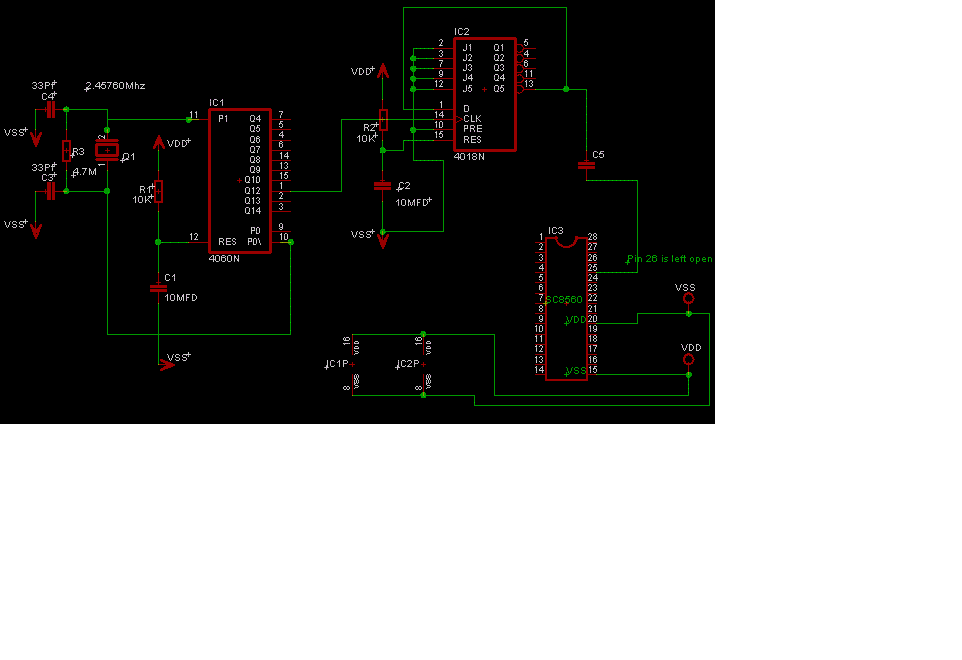

I have attached a positive version of your circuit as I found the negative one tedious to look at.
EDIT. I downloaded the data sheet of the SC8560. Now I understand why you had to transpose Vdd & Vss. However, you don't need C5. Just connect it directly.

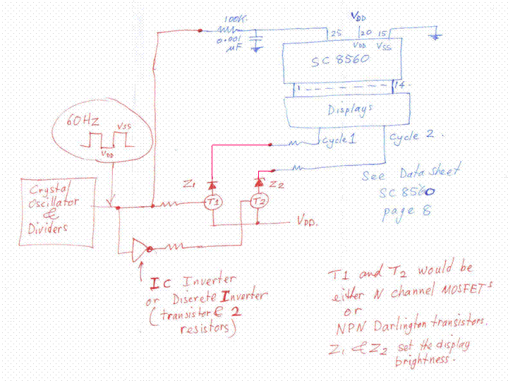

There are several ways that it can be done. Some examples:-
1. Install 2 MOSFET transistors and Zener diodes to limit the voltage to ensure that the display brightness is correct.
2. Use 2 Darlington transistors and 2 Zener diodes.
In each option, the inversion can be done either with an IC inverter or a small signal NPN transistor.
I am happy to design this for you all, but I need to know the AC voltage (RMS) of the transformer winding that supplies the "Cycle 1 & Cycle 2" signals, ie. measure from the centre tap to one of the diode cathodes.

EDIT. See the other thread in the "Data sheets/parts requests" forum.
EDIT 2. I have attached an outline of one possible solution.
EDIT 3. I have made minor improvements

Hi Arun, Please try attached diagram.

I had not thought that the Vdd supply voltage would not be adequate to supply the display, but, in the original arrangement, obviously the energy comes from the transformer.
I don't understand why you would need a H bridge.
The use of a 4013 to generate anti phase signals is a good idea.
The circuit posted above by sarma looks good to me. I assume Q1 & Q2 are Darlingtons.
Is 330 Ohm sufficient for R3 & R4 given that the supply is now rectified rather than half wave sine pulses?
