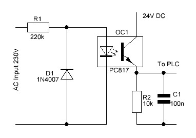

My plan is to use PC817 optocoupler feeding 230V AC via 220K resister & a series diode & the optocoupler output (collector resister) feeding via a 24V DC supply & getting Vout from emitter side.
Is that ok?
Guys this is the circuit I'm going to use.
Is this ok?
Is this ok?

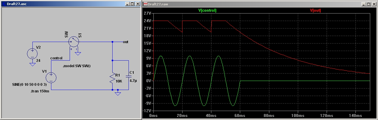

No, the time constant RC is too short. You will need something more like this. Even here, the tradeoff is how much sag you can tolerate during each half-cycle vs how long after the AC turns off the input drops to a logic zero?
Make sure any components mains side are correctly rated voltage wise. Most cheap resistors aren't despite having an adequate power rating.
