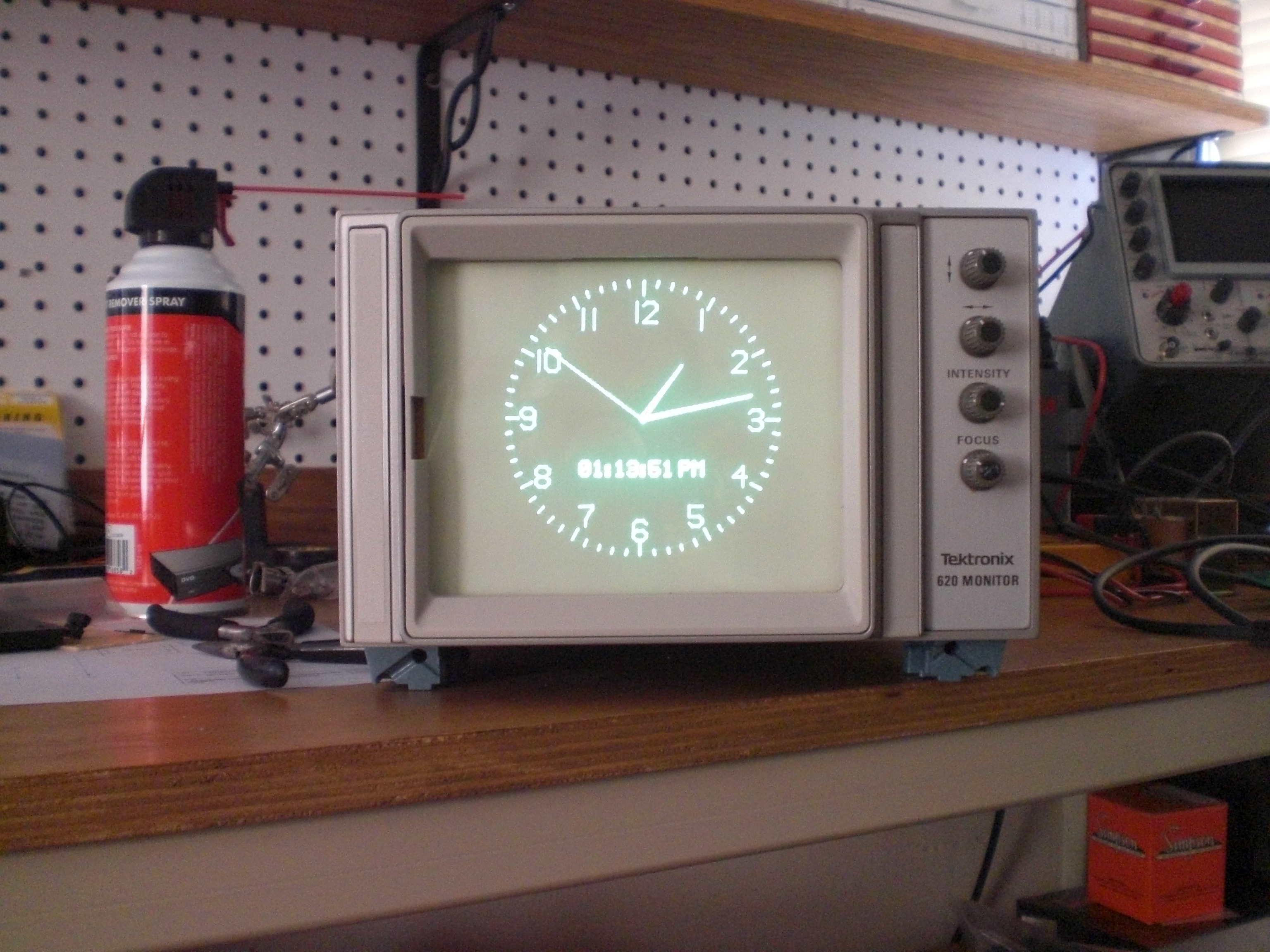

I have seen these Scope Clocks on E-bay and I see Dutchtronix puts out a kit. Well I couldn't resist and bought the kit. Anyone else have one?
I think it completes the uber-geek look I was going for.

Does the kit convert a normal scope to a clock?
Will it work with digital scopes?

Yes it will work with an analog scope anything over 1 or 2 Mhz I would go with 5 Mhz to be safe. The clock can generate anywhere from 0.5V to 5V on each axis. Make sure the scope in question has an XY mode, this will not work in timebase mode.
Digital, no won't work with cheep ones, maybe higher end digital.

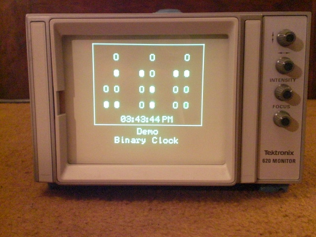

It will display a binary clock

Pretty neat. Looks like it would need to use the Z-axis input to blank the retrace. Have you got a way to keep it from burning the phosphor?
Just an X&Y input (If you look real close you can see faint connecting lines on the dial)
The program in the AVR has a "shift" built in to slightly move the clock face every hour.
