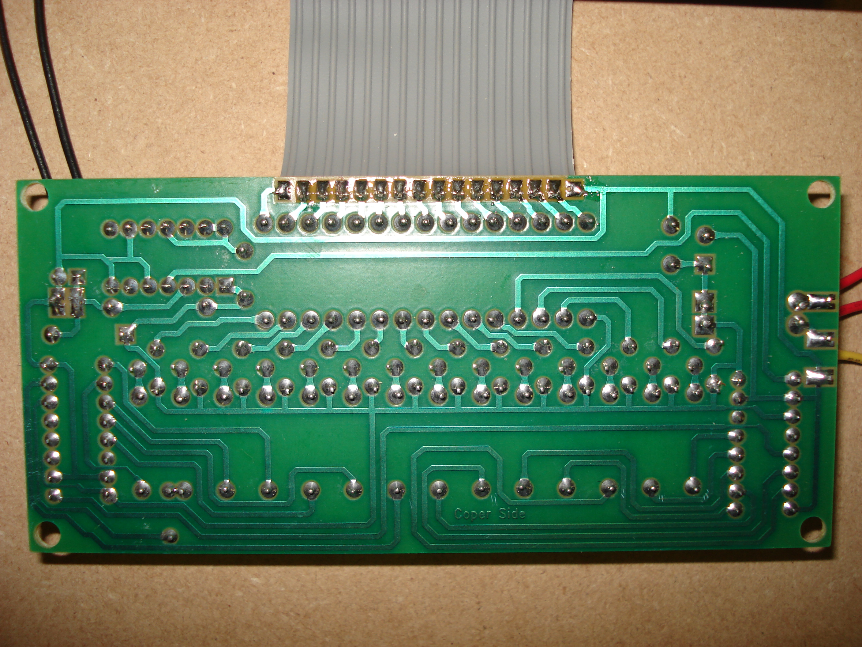

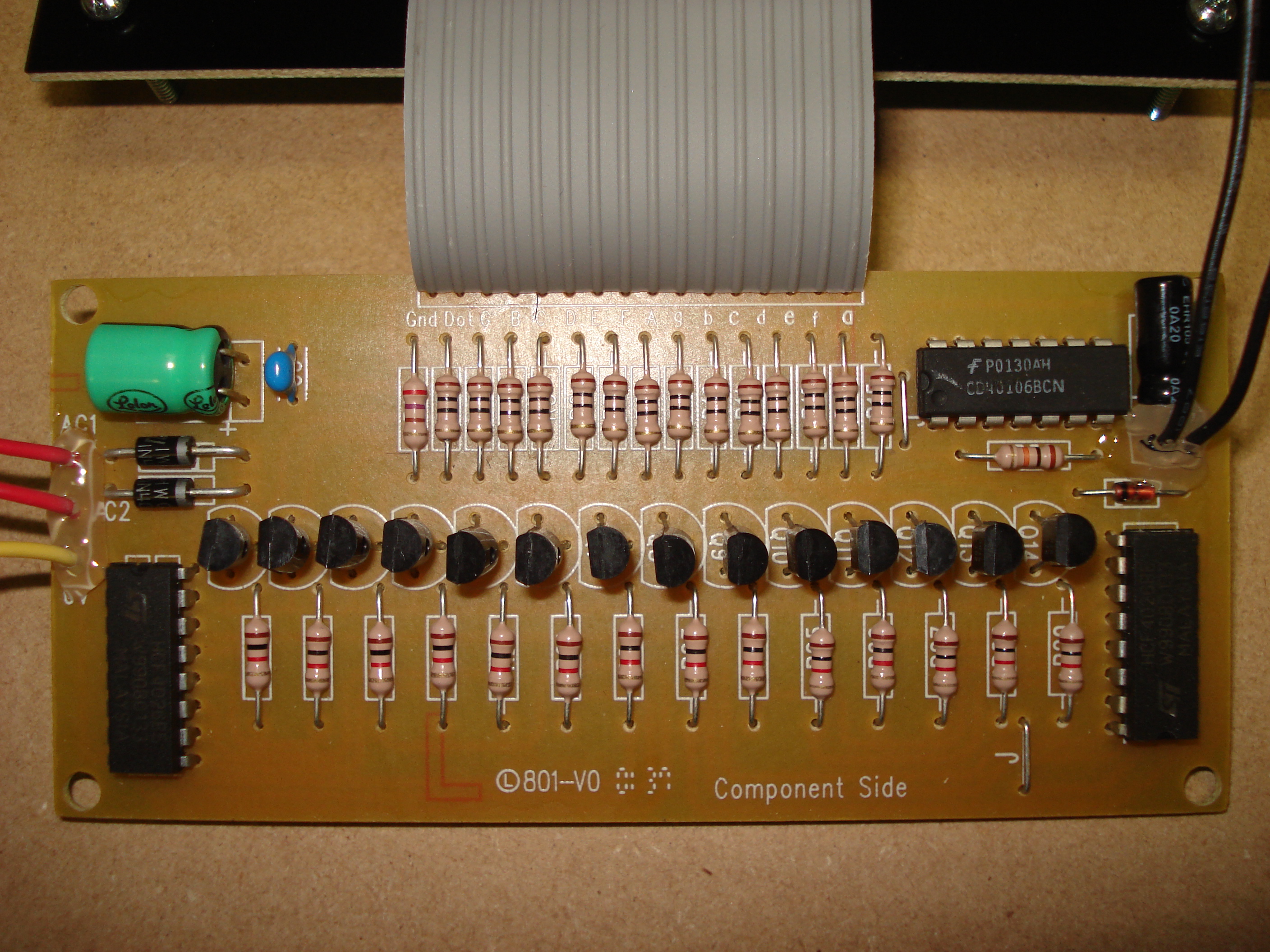

Ive attached pics of the circuit board. On the left you see the three wires for power. The yellow on the bottom being the - the middle red being the +. Do you know what the top red wire is for? The instructions coming with the kit instructed to cut it.

I tried the experiment but it didn't do anything. I probably didn't do it right or something. Basically I have to create a connection with a momentary button from the positive supply to pin 15?
Basically that's correct.
I looked at your pictures and they didn't hook it up the way I expected. Was worth a try. I'll study the pictures some more.
[edit]I looked at the photo. Here's what you can do: Make a parallel combination of a 100k resistor and a 10 nF (0.01 uF) capacitor. Remembering that this is static sensitive, lift both pins 15 out of their holes. (Watch, the ICs are the other way around, and avoid damage to the fine traces between pins 14 and 15). Connect them together, and also to one end of the assembly you just made. Connect the other end to 0V (pin 8 is handy). This is your 'reset' pin.
The bare necessities would just put a push button between +V (pin 16) and this reset pin, but I would put 1K resistor on each wire as it leaves the board to protect against static electricity and short circuits. Your call.
The red wire is not +V as it has a diode in it so the board could work on AC. (The second red wire could have been used as another power pin.)[/edit]
