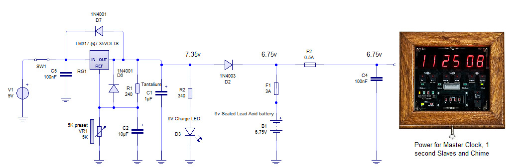

I want to build battery backup for my Master Clock so it keeps running when mains fails.
My Master Clock page is here.
I have the basic charging and backup circit (see diagram) using a 6v sealed lead acid battery.
The circuit works fine but my only concern is that a long power cut will discharge my battery too far and shorten it's life.
Is there a circuit for discharge protection so I can preset a voltage where my battery is taken out of circuit?

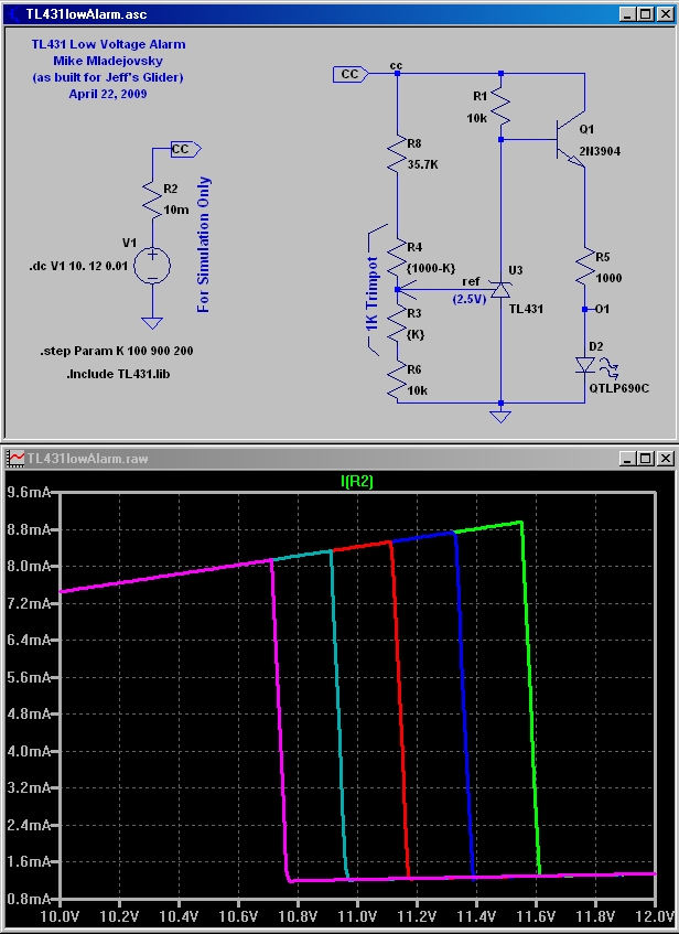

Here is something I posted for just a visual LED indication that a 12V SLA has discharged too low. You can use this basic circuit by tailoring the voltage divider on the Ref input to the TL431, and modifying the output side to switch off your load. Can you do that, or do you want some help?

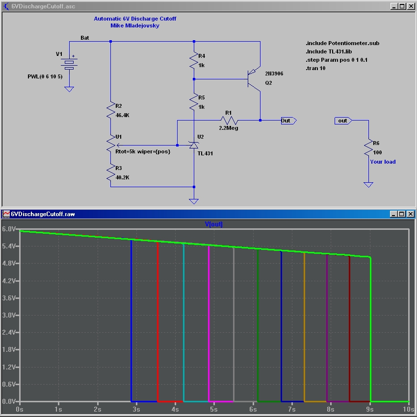

Here, I modified it for you: Scale the time axis to match the discharge time of your battery. What do you want to use as the final cutoff voltage? If I didn't guess it, you can play with the resistive divider. I'm taking a wag that the 2n3906 will drive your clock. If not, you could use a bigger PNP or a PFET.

In your circuit if the battery was disconnected when it dropped below a set voltage would it try to switch back on when the battery voltage raised again due to no load?
If so I could use the OP transistor to switch off a relay instead of the battery. I could then configure the relay to hold itself off via it's own contacts. Therefore once the voltage threshold had been reached the relay releases shuting down the power to my clock and holding itself off.
A reset button would have to be pressed to reset the relay.

The battery is floated at 6.75 volts.

The circuit as presented the last time already exhibits some hysteresis, as defined by the 2.2meg feed-back resistor. It creates a nice clean switching threshold, and the circuit will not cut back in until the battery voltage is about 200mV higher than where it cut out.
The attached circuit as modified to increase its load switching capacity by replacing the PNP with a PFET. It will now switch an Amp or three. I also modified it so that it includes the explicit push button to restart it. Note that I lowered the estimated load being switched to 20Ω.

hi Mike,
My experience with SLA batteries shows that the battery will 'recover' to a voltage much higher voltage than 200mV, as soon as the load comes off.
I would predict the circuit will tend to repeatedly switch on/off, at the battery low point.
Good Point! Either modify the circuit to increase the hysteresis or use the version with the push button, which will not start again unless the button is pushed.
Thanks you so much for your help on this. The push button idea is great! I will give it a try on breadboard as soon as poss and let you all know how I get on.

(edit)After looking at your clock schematic, it seems you use the 7-seg display drivers as part of the clock itself, so you can't power them down to conserve energy, BUT you could drive the common cathode of all the displays with a transistor to ground, and operate the transistor base from the 7.35v junction in your backup supply. That way the displays will power down in a blackout but the clock count itself will be maintained, and current should be down to a handful of mA.
