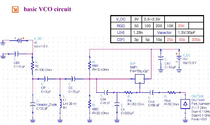

hi friends
ths VCO cricuit can u tell me is it well work upto frequeny as tolad upto 3Ghz and what is that s2p and snp1 and that squar share on the cricuit plz reply if u know .

That is an Agilent ADS schematic. Snp1 is a 2-port "black box" whose performance is described in the frequency domain by the file "bfg.s2p".
I suspect bfg.2sp is an s-parameter file of some specific bipolar transistor. You would at least need to know what type of transistor it represents.
