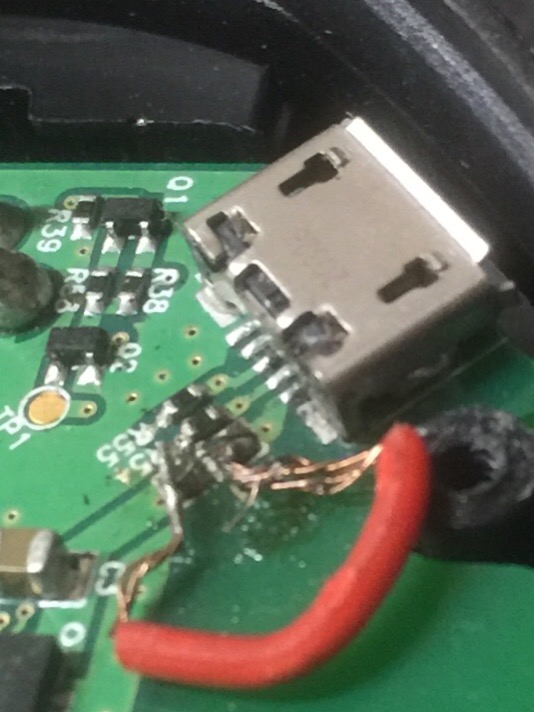

sena smh10 bluetooth usb not charging blown ferrite bead
Or some solder dripping on the connector just below the red circle in above photo. Not, that connector looks much cleaner in your photo from Post #1.
No I made sure there was no jumping the pic was taken before I powered it up and made sure there was no jumpers ie the one you have marked was removed the switch off was a problem before I removed the(bead) and put wire on. It would just flatten battery and not charge it but the wire jumper has that working

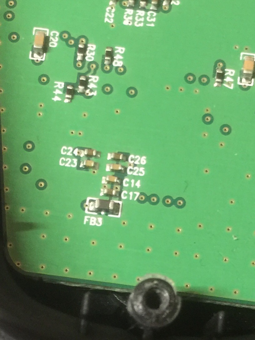

Can’t see any solder drops on it any where also if you see the FB3 at bottom of second picture it’s the same component as was in FB1
