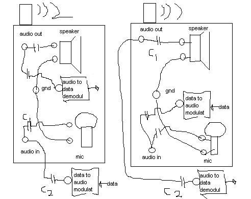

hi i need help! i want to send data via a uhf voice tranciver(walkietolklie) with a low bitrate(i dont mind). so ineed some good ideas about that. i have a pair of uhf transceiver with a total bandwidth of 700khz and it is from 700khz to 1400khz. so i need to convert data to voice and then voice to data.plz help

man here is paint about! i know its hard! but plz give a try! i need those 2 boxes (audio2data mod & data2audio demmod)!!!!!!!!!!! thats what i need and if i get those 2 boxes i ll have both data and voice com!!! and i dont mind if i have a beeep on speaker when i send data! thnx a lot!!!

It sounds like you are describing a modem - modulator/demodulator. Sometime between the time that dinosaurs ceased to roam the earth and the present time, computers were linked to each other via a telephone modem. You put the handset in the modem's cradle on each end and the modem converted the datastream into audio (modulate) and then at the other end it converted the audio into a datastream (demodulate).
With your transceivers you'd be limited to one way communication however you could use two pairs for two way communication.

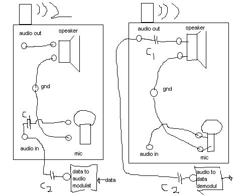

pls take a look at that photo is it or not HD 2way com??? IN ONE PAIR???

It's only one way at a time, which means you have to control RX/TX switching as well, you might also consider the legal implications?, are you permittd to send data on the frequency in question? - most usually NOT!.
I suggest you try googling for "packet radio modem", which is what radio amateurs use for data communications, on specific allocated legel frequencies.
a microphone can be considered as a speaker, so your hand drawn diagram indicates to me that your microphone will function exactly the same as your speaker, because they are connected in series.
An electret mic can't be used as a dynamic speaker, but a dynamic (coil and magnet) mic can.
They aren't in series. Both are connected to ground.

normally I don't answer completely wrong, but this time I did, because his ground symbol was not a standard one, and his circuit looked like he drew it in 10 seconds.
When I was answering, I missed the ground symbol.
