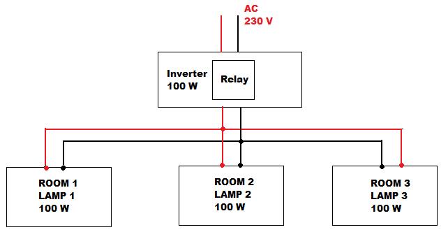

Hi everyone,
Its my new project for my home.
Please refer picture.
I have an 100w inverter and lets assume there are 3 rooms with 3 100w lamps.
While the power is live it will supply power to every load.
If power goes i can use anyone lamp at a time since my inverter is 100w.
Usually we used to connect anyone partcular lamp with it.
But i just want to turn ON anyone at a time.
1. So when power goes OFF i have to switch OFF all my loads and switch ON my inverter manually after that i can switch any one lamp, this is one method.
By mistake if switch it ON my inverter with two lamps, my inverter will burn. I can keep overload breaker for this.
But All i need is, i want to calculate the loads connected to load before switching ON my inverter manually.
1. My idea is i can send 3v dc supply to 220v AC bus when power goes OFF, so that if i switched OFF all my loads there wont be any return of 3v so my LED will not glow in my inverter side then i can allowed to switch on my inverter. if glowing means some lamp is still connected, i can check untill LED goes OFF.
I am just telling my basic idea, but for real scenario there are lots of loads will be connected to 230v bus, even i can switch it OFF all but i want to ensure all the loads are disconnected before switching ON my inverter, but i cannot do anything with power indicator and few loads. So LED method will not work, i cant stop LED glowing.
So, Is there any other method available, shall i send particular frequency and compare with return frequency?.. anyone have idea, please suggest me.
Thanks.

hi mytech,
The problem with the 3Vdc test supply is that you will read back thru the inverter output winding.

Then LED test is an simple idea only just injecting volt through phase line and reading in neutral line, if closed i will gt the same volt. For only 3 lamps it will work. But there will be lot of loads connected to bus. So i am in need of some other method to identify the connected loads.

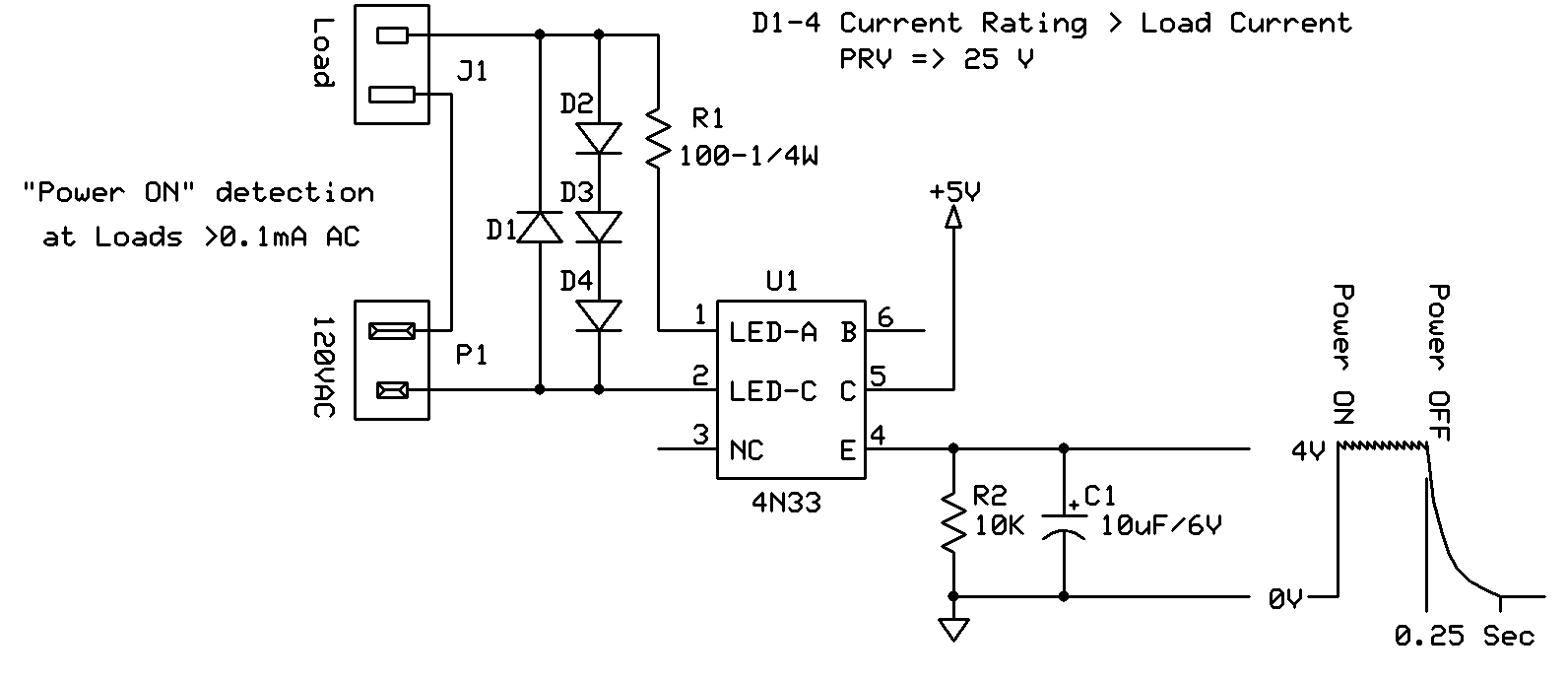

OK, this circuit will let you detect the presence of load(s) >0.1mA AC.
For detecting different levels of current draw, you might want to look into "current transformers".
Ken

Thanks for your circuit, but the reqirement is before switching ON my inverter i have to sense whether all loads are disconnected or not. After giving power via inverter i can use this current tranformer everything to protect inverter.
But how can i identify simply, all loads are disconnected from the bus before switching ON inverter?.. So current not gonna play any role before switching ON inverter. I just want to inject something and compare the return with the source, If i am not getting anything then there is no load connected to bus, i can switch ON my inverter but practically not possible, thats wat asked frequency will work??
Thanks.

I made the assumption, because of the relay, that the loads were being continuously supplied by the 230vAC bus. And when the bus failed you would manually or automatically (with the noload qualification) switch on the inverter. My circuit would be used to indicate to some device that there was a load prior to the buss failure.
If the relay completely isolated the loads from the buss...and the inverter...you could just ohm-out the load circuit.
Ken
