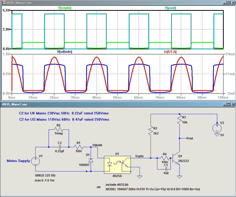

Thanks for your response. I'd like to clarify my question. I want to detect the output of the motion sensor and only output a safe, low dc voltage. I need something small enough to fit inside the small area available in the light's base. Most transformers or wallwarts will be too large. I would like to use a opto-couple for it's small size and low power consumption.
Also, I would like to restate my commnet about being completely passive. What I mean is, I want it to be self-powered. I don't want to have to connect the DC supply to the non-isolated portion of the detector. So, I would be OK using SCR's Triac's, etc. if that is necessary. If I can get away with passives only, then that would be better. Otherwise, I will design something with active devices.

Look at this circuit, it should fit inside the PIR housing.
NOTE: the driving side of the Opto-isolator is NOT isolated from the mains supply voltage.
That's very cool. I only need the output of the opto isolated. At first I thought c2 might be huge and expensive, but digi-key lists some polyester caps that will just squeeze in, and only a couple bucks a throw. That value gives for rms current:
1/2Πfc = 1/6.28*60*.47µ ≈ 5.6K for the reactance, and for RMS current at the opto:
60/5.6k ≈ 10.7 ma. That should do it. :)

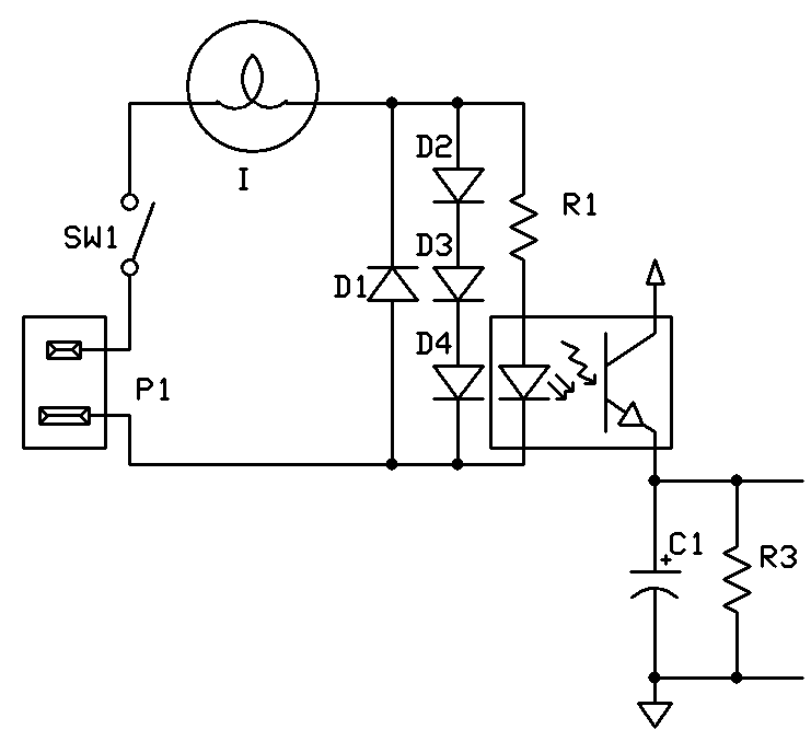

Oh, and BTW, I found this on another thread, in case anyone is interested. It's sort of related to my original problem. This circuit senses and indicates when an appliance it connected and energized!
