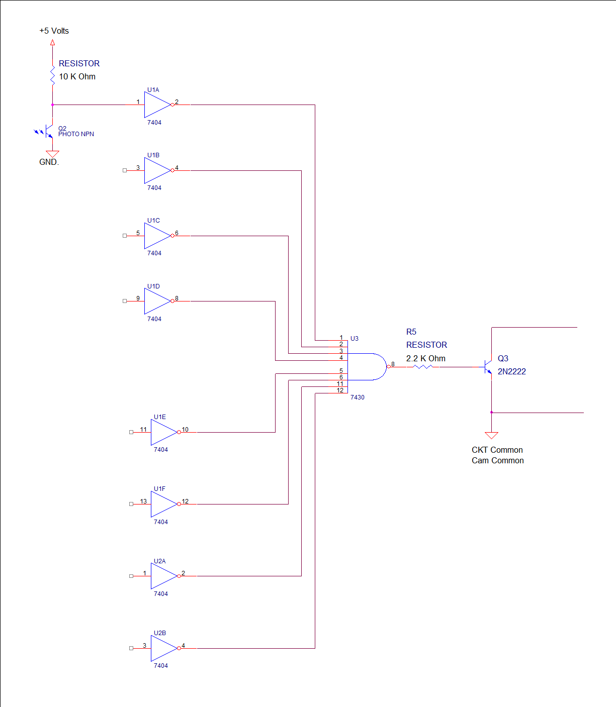

I will draw the "Front End" (sensors) in a rough and tell you what to do with the unused pins later today, likely after work. :)
Ron
Hi Ernie
OK, took a few min here at work. Attached is an overview of what we should have. When the LASER is striking the photosensor(s) they will be in an ON state placing the input pins of the 7404 hex inverter at a logic low. Any unused 7404 pins should be tied to ground/common/logic low. Logic low for the 7404 should be below 0.8 volts. So in a normal state all the outputs of the 7404 sould be a logic high to the 7430 NAND gate. Since it is NAND the output should be low from the 7430. That will hold the transistor turned off.
When any input to the 7404 is interupted (beam broken) the corresponding output will go low from the 7404 to the NANG gate and the 7430 output will go high turning on the transistor and triggering the camera.

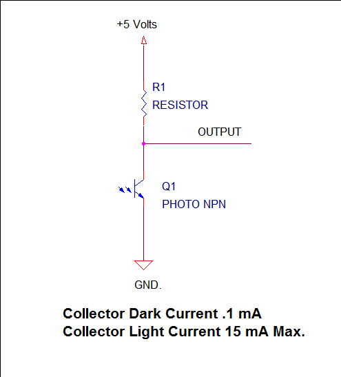

The photo transistor section should look like the attached image. Looking at the data sheet they tell me in the dark the current is ablut 100 uA or less. When the LASER is striking it the current can be 15 mA (max). If we drop the series resistor to 500 ohms from 10K it may help but originally I was not wanting to run any current to speak of through the photo transistor. 500 Ohms would give us 10 mA of current when the photo transistor is on state.

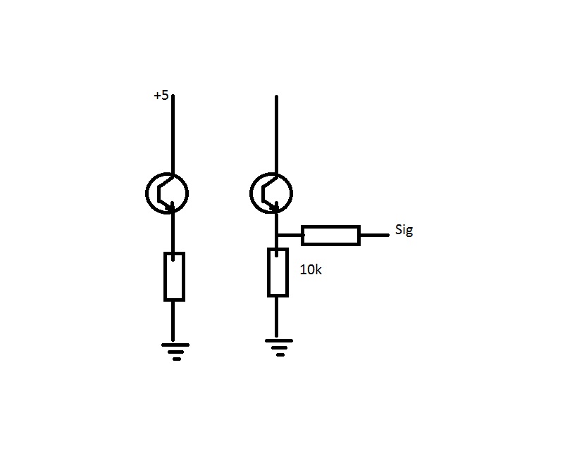

This is the thing that concerns me, The way the sensors are normally connected to my trigger unit is the right hand sketch, connecting it your way does not work. I am making this to use it's own power supply, normally it would use the power from the trigger unit.
The left hand sketch is the way I got it working.
The current at 15ma is that too much, with 5 PT's that would amount to 75ma, the power unit I have added should be ok too 1 amp. Ernie

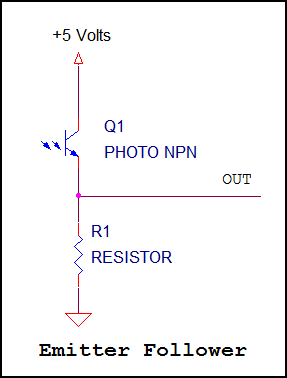

I don't get it. The circuit you are using with the NPN Photo Sensor is actually an Emitter Follower circuit. Taking the signal off the photo transistor emitter. The output will be the opposite of taking the output off the collector using a collector resistor.
When light is striking the transistor it will be on. That will place close to a logic high at the output. Close to because there will be the forward voltage drop of the transistor to subtract.
Also, before I forget, the 7400 series ICs used are 5 volt chips. They are designed for 5 volt power and TTL (5 volt) logic.
