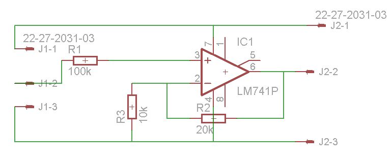

Hello,
just build an signal amplifier which is meant to amplify by 3. Now all it does is having about 4.5 V at the output and the inverting input, whatever happens at the input. Did I kill the op amp?

The LM741 is difficult to damage.
It's not a single-supply op amp. Your circuit requires a separate negative supply (a minimum of 5V) on pin 4.

What is J1-2 connected to.? [ end of the 100k] and what is the voltage on J1-2.??
I see. I put in +6V and 0 (battery) and its going to run on +9/0 V, just trying it first on a veroboard before I do 8 of them. So it wants to have a balanced voltage?
Shall I rather go for another chip, LM358 or so?
edit: r100k goes to an LM35, had 180mV. But I pulled the resistor out, just to check, same. Put 1.5V onto the input of the LM741, still the same. Shortened the 20k resistor, voltage went down (same both ends of the 20k, thats what its meant to do). But still, seems to go into saturation? (suppose 4.5 is max when you put a nominal 6V accupack on)

The 741 has a very poor spec,.
The output voltage will never go higher than about [Vsupply-1.5V] and never lower than +1.5V above 0V.
A LM358 has the same high output limit but will go close to about 20mV above 0v.
These figures are for a single supply.

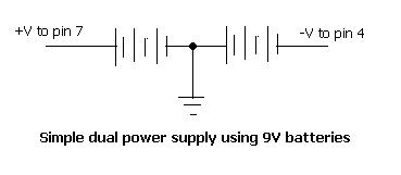

While the 741 is an old chip, it is very suitable for what you are doing. However, it does reguire a dual power supply to operate properly. It can be used single supply, but with an entirely different circuit than what you are showing.
For a simple dual supply, simply hook up two 9V batteries head to tail, with the ground drawn from between them and your circuit should be fine.
Edit: see attachment

The inputs on the LM741 do not work when their voltage is less than 3V above the negative supply which is 0v in your circuit.
Some 741 opamps do not work when their supply is less than 10V.
It seems that Multisim does not know these limitations.
The LM741 and the LM358 are very noisy. You might see the noise when the input voltage is low.
An TLE2141 opamp is low noise, has low input offset voltage, has wide bandwidth, has a minimum supply voltage of 4V and has inputs that work down to 0V in a single-polarity supply circuit. The output goes down very close to 0V in a single-polarity supply circuit.
