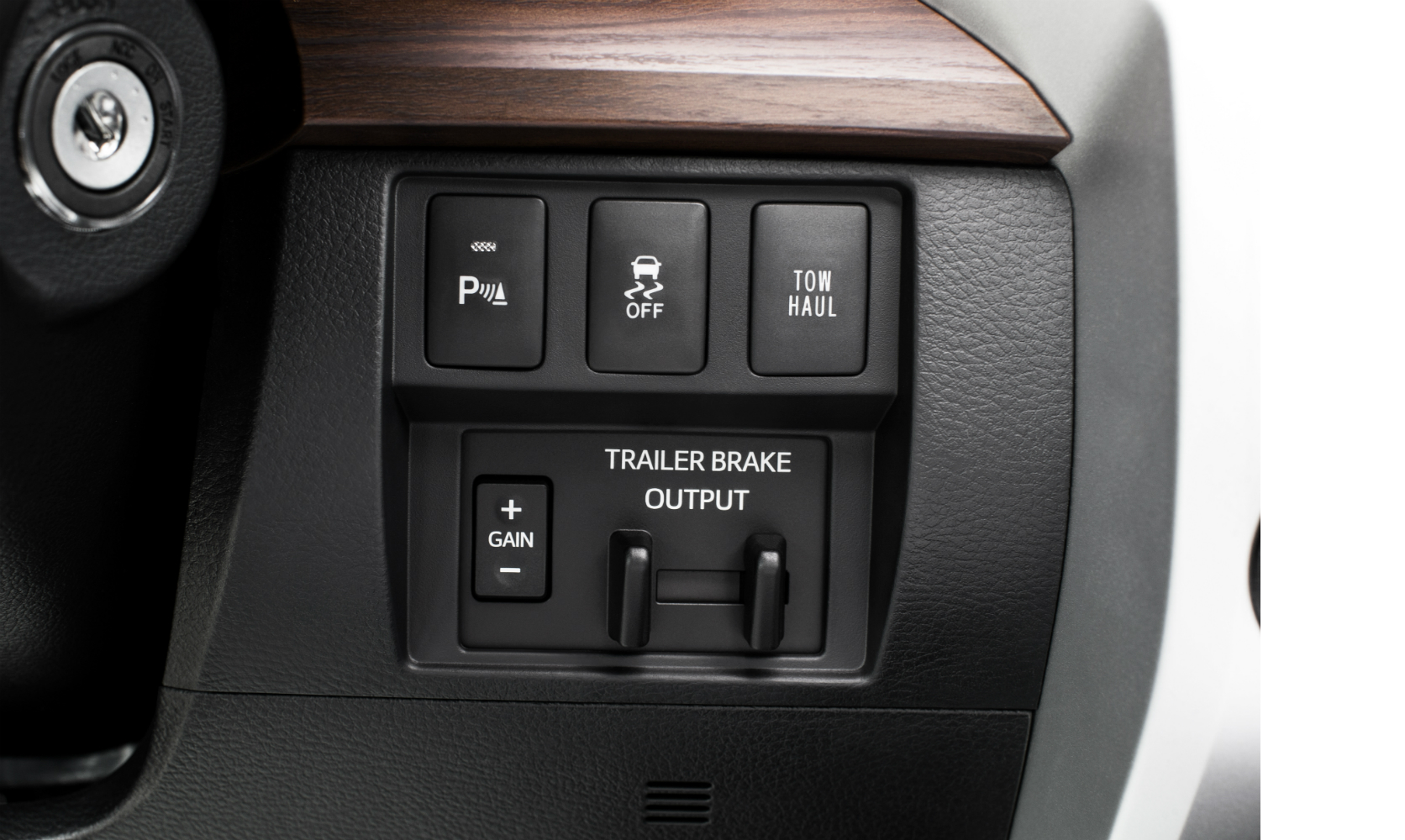

Guess what my Tundra has!
"Built for towing, the Toyota Tundra is available with an Integrated Trailer Brake Controller."
I just access the on-board screen to activate it.

It's possible that it will just work and illuminate the light. However the car will alter the mark-space ratio to make the braking proportional to the deceleration.
It is possible that a relay operated by the brake wire would give more consistent results.
Also, check it stays on when stationary on the flat. The brakes my be deenergized in that state.
Otherwise, find the brake controller connector and it probably has the brake signal and the blue wire. Leave the brake controller disconnected, and join the brake signal to the blue wire in its place.
