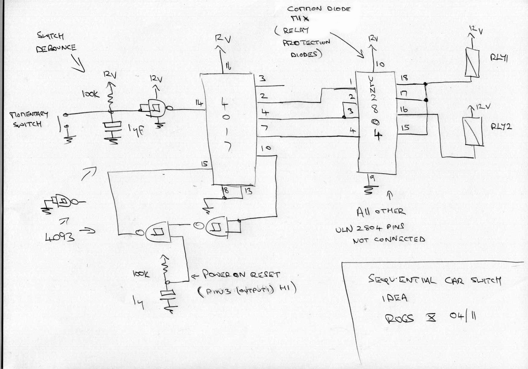

Taking Brevor's idea, but adding a ULN2804, to provide both the logic you require, the transistors to power the relays, and the relay protection diodes to protect the output devices. Minimum component count for logic, switching and protection!!
Schematic ideas sketch attached.
Edit: The 'power on reset' (POR) time constant needs to be longer than the 'switch de-bounce' time constant. Make the POR resistor 470K.

The 4017 outputs are routed through diodes to give the proper outputs for each state.
The sketch I gave in post #4 does the same thing as Brevor's diode mixed outputs, but uses mixed 'open collectors' from the 2804 . As I say - the simplest option to do what you need.
Power on - 4017 pin 3 High. All other outputs low. Both relays off.
1st switch press - 4017 pin 2 High. All other outputs low. ULN2804 pin 1 high. Turns on output from pin 18. Energises RLY1 (connect sidelights to RLY1 contacts)
2nd switch press - 4017 pin 4 High . All other outputs low. ULN2804 pins 2 and 3 high. Turns on outputs from pin 17 and 16. energises both RLY 1 and 2. (headlights connected to RLY 2 contacts). Both headlights and sidelights on.
3rd switch press - 4017 pin 7 high. All other outputs low. ULN 3804 pin 4 high. Turns on output from pin 15 . Energises RLY 1 only again. (RLY 2 is now off)
4th switch press - 4017 pin 10 connects to pin 15 reset. 4017 pin 3 goes high again. All other outputs low. Both relays off.
It really doesn't get any simpler than that!!
Is that what you want?

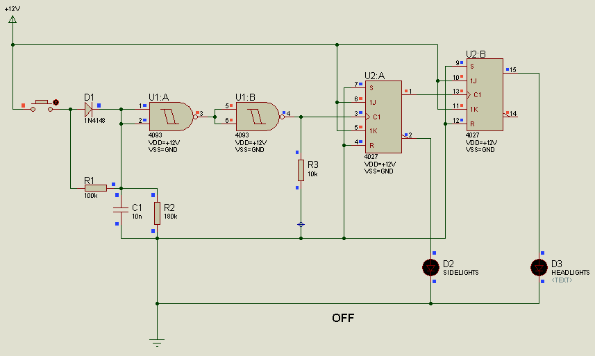

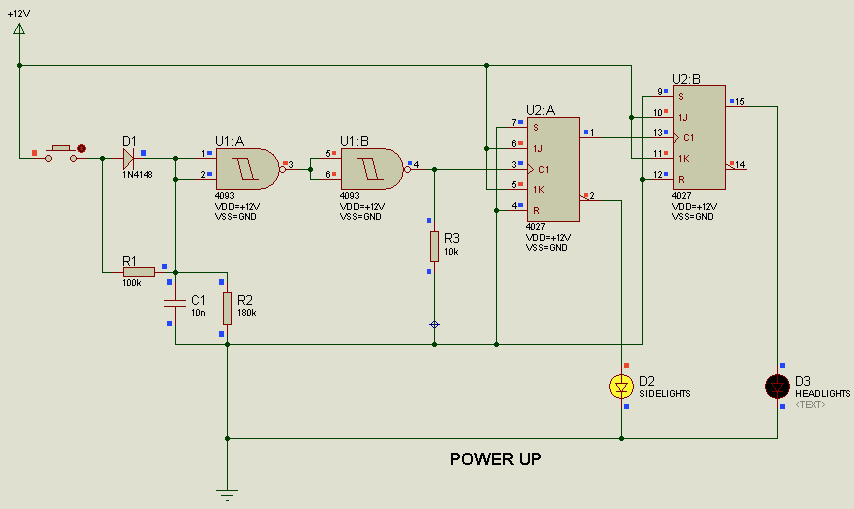

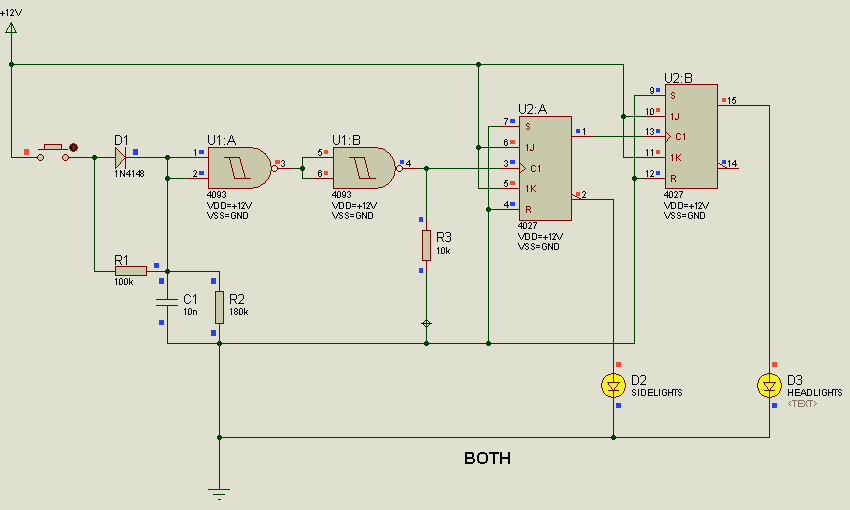

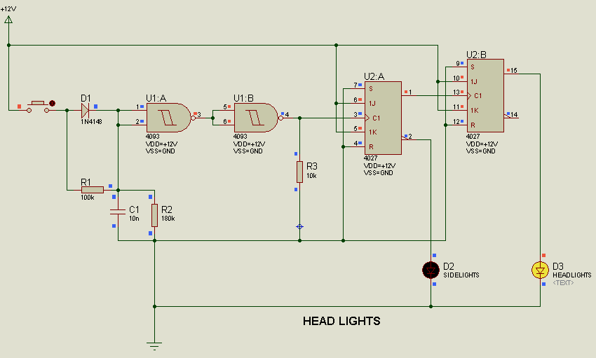

The 4093 makes a debouncer circuit with approximately 150ms on time.
DC filtering and decoupling capacitors omitted for circuit clarity.
Boncuk -- you would still need to add the relay drivers (and protection diodes).
I think you might need to lengthen the debounce time constant a bit - depends on the switch of course, but with the variation of thresholds, depending on the 4093 manufacturer, a bit longer might be safer.
What's R3 for?
I know that! It was just a circuit suggestion.
I guess nothing has to be lengthened for the debounce time. The debouncer circuit switches output to high as long as the button is depressed + 150ms. No chip manufacturer builds CMOS IC which can't work in the milliseconds range.
What's R3 for?
R3 is a leftover of a foregoing experiment. It has now become a base resistor for T1 (relay driver for the side lights).
Last not least, how about throwing in your own suggestion instead of criticizing other member's posts?

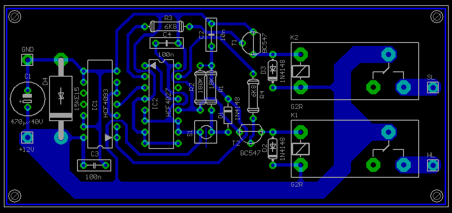

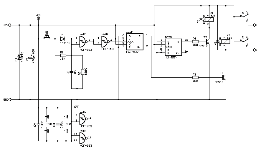

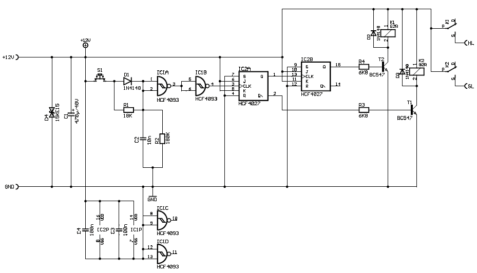

Anyway, here is a full functioning circuit including a PCB design.
Boncuk

Can I refer you to the schematic I posted in post #4 ?
I thought it might be useful to include the relay drivers, and their protection diodes in one simple chip.
Shame you haven't found the time to glance at it . Could have saved you the trouble of starting all over again.

Ok thanks Rogs and Boncuk,I like the latter design better purely for the lower component count.

A massive thank you to Boncuk for the schematic and the PCB design which is a LOT more than I was expecting,is there any chance of the CAM files for this please?

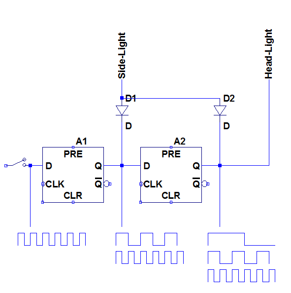

Here is what I came up with.
1-of-4-switcher-gif.52329

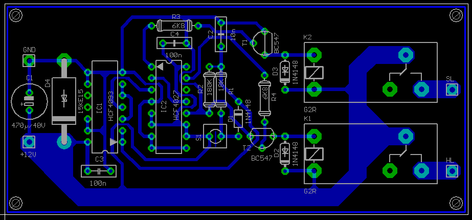

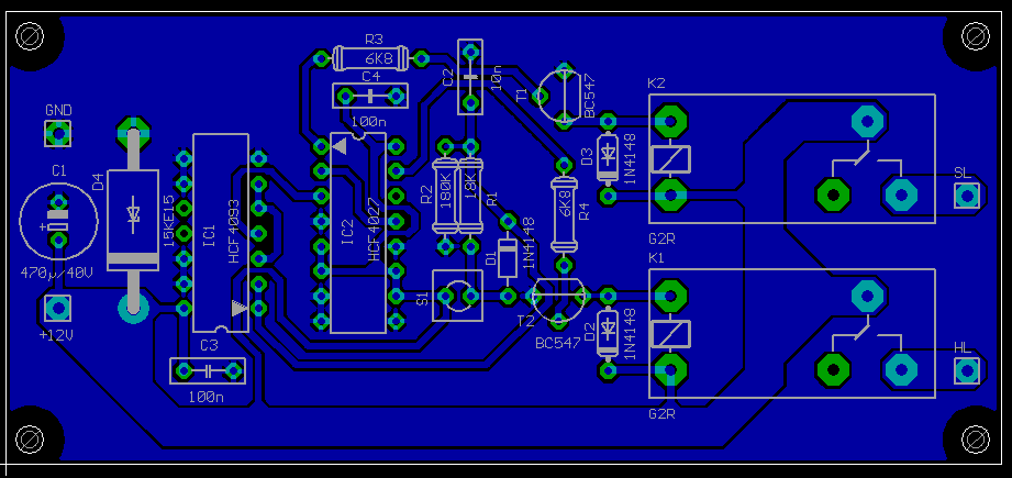

Hi Chris,
the original design started out with the side lights on.
After circuit modification it starts in the OFF-STATE when powering it up.
Here are the revised schematic and PCB design.
I also added a third image showing the PCB with a ground fill. Using ground fills etchant will work for many PCBs not dissolving much copper, thus being an advantage for a cleaner environment. (I'm not green.).
Board size is 100.33X46.0375mm (3.9500X1.825").
To obtain the Eagle files please PM me your full name and email-address.
Using Eagle you can print the PCB image without distortion and scaled 100%. Converting the *.brd file to e.g. *.pdf the result won't be properly scaled making it difficult (if at all) to place ICs.
Download Eagle light (free version) at
With the files I will give you instructions how to print the PCB layout.
Regards
Boncuk
