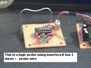

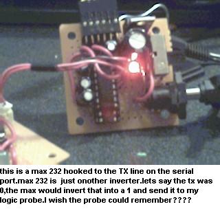

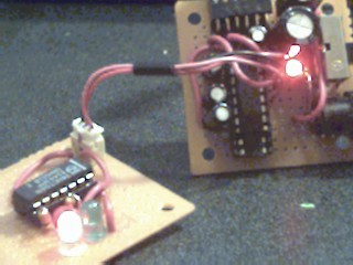

:? I hooked a maxter 232 to my serial port,I have a program that sends the data threw the TX line,,,,,I have a 74hcto4n hooked up as a prob.there is a light for ground "0"Green,,, and a lite for "1"red,,,
Now here's the problem.The light's work at low speeds lower than 1200 buade,,,But the 74H cannot switch back and fort at the high speed's Therefor both lights Dances back and forth butt both are always on,Just that the dimnes will dance.Now i want to capture the data bieng sent from the serial port?I dont want to see lights dancing i want to store the data so i can read it later or dissasemble it.My question is what can i hook to the circuit that i have built to help me store the data so i can retrieve it later.I will provide pics of my chip later to help you better understand.Someone please tell me that this can be dun,Thanks...

I read what you wrote in the first place, and it still doesn't make much sense?. I presume English might not be your first language?, but as you haven't filled your location in, it's hard to know!.
But, from what I'm 'guessing' you mean, here are a few points!.
1) Your circuit looks to be working perfectly, but has no relevence to your requirements! - all it will do is flash red and green LED's depending on the serial data stream - which it appears to do quite happily!.
2) Disassembling - this means disassembling assembler code to produce source code, what has this got to do with what's going out of a serial port?.
3) Try posting EXACTLY what you want to do, not how you currently are trying to do it (which doesn't make any sense).

You can simply use another PC to monitor the data on the RS232 line!, there are plenty of freeware programs about to do just that.
exactly...
if you are trying to capture RS232 signal for debugging purpose,
why not use computer and some sort of terminal program.
that's exactly what i use when programming or troubleshooting
serial connection. Hyperterminal is included with every version of
windows and linux usually come with minicom.
if there is a problem and you want to take a look at waveform,
try oscilloscope. Storage scope would be proper choice.
naked eye is way to slow to do the job with your hardware.

ok, do this:
make a crossover cable using two DB9F connectors using simple three wire connection (2-3, 3-2, 5-5).
use it to connect two com ports (either two PCs or two com ports on a same PC).
open one Hyperterminal (or whatever other 'therminal' you have) for
each port and set them up for same baud rate and click on connect icon (both terminals!). since we use simple cable there is no hardware handshaking (choose 'none').
If you type something in one terminal, same text will show up on another.
if you try to type on other, that text will show up on first one - just like in ICQ for example.
Now if you disconnect one end of the cable and plug it to some other device (anything with RS232 port), you can see what that device is sending and if you want to 'talk' to it, just type message or command it can understand.

74LS04 is not too slow to turn LEDs on and off - it is way too fast for your eyes.
that's why the LEDs appear to 'dance' - they are turned on and off many times per second.
you can make some shift registers for example to capture streams but it's not worth the trouble. most messages are 20-200 characters long and each character is one byte (8bit). since you are trying to work with discrete components, that means some 20-400 chips, 160-1600LEDs etc. even at $0.05 per LED and $0.50 per chip you are looking at some spending, lot's of wiring and troubleshooting etc.
by the time you are done looking for suitable breadboards in your catalog of choice, you could have tried out hyperterminal and be playing with communication.
if you have any programming software (VB, Delphi, Pascal, QBasic, anything...) you can write your own terminal. This would have big advantage that you could use it to not just send/receive but also generate codes and act in a certain way depending on response from device. yes this can be done manually but it can take veeeeery long time and it's so much faster and more comfortable to make computer do bulk of work for you, have option to save and load bunch of data so you can really study it.
