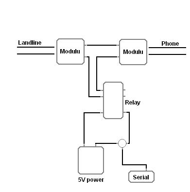

Hi
I hope someone can help me with this
I am tray to make Screen saver and when the Screen saver start I send command to the Serial port
and open the Relay and then the phone don't ring when I am not in work or not sitting with my desk
this is plan how I want to make this
I thing I will use 5V adapter from mobile phone to power this
what I need help with is to make this safe so I don't burn my computer or my desk :)
when the relay stay open over the night
Regards
S.S.G
Yes I was thing to use this in that way use the 5V from the USB and let the Relay stay open when I am working
and close when the screen saver go on,
then it is no power on the Relay when I go home and the landline don't work until I use my computer day after,
but is it not risky to use USB to power this for 8 or 12 hours over the day and is it change the 5V go into the serial if something happend?
The landline is 45V DC when your phone is off but when the phone ring it go up to 90V DC
it can not go from the Relay into the Computer ! well I hope hehe
The ringing voltage is actually 90-130Vac at 20Hz.
