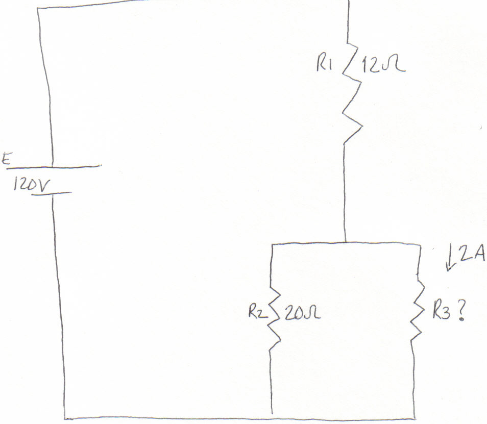

i need help finding a missing resistor in a series parallel circuit. My source is 120v. R1 is 12ohms. it is connected to R2, R3 which are parallel to each other. R2 is 20ohms i dont know the current flowing through it. R3 is the missing resistor, but the current flowing through it is 2A. how do i fing out what R3 is?????????????? once i find R3, then i can parallel R2R3, then i can say that they are in series with R1, but!!!!!!!!!! i dont know R3?????????

R3 = 30 Ohm
Since this looks very much like a homework assignment I let you work out how :D this value was obtained.
Hint: work backwards :wink:
Klaus
Hi Pasebay,
Instead of using a complicated formula, I just used common sense:
1) Quick check that 12 ohms can supply more than 2A. Yeah, way more.
2) If R3 is 20 ohms like R2, then the parallel combination of R2 and R3 is 10 ohms, and the current through that 10 ohms + 12 = 5.45A. Divided by 2 = 2.73A. Too high.
3) Tried 30 ohms for R3. 20 in parallel with 30 = 12 ohms. Therefore the voltage across R3 is 60V and it passes 2A.

i thought of the trial and error method, but i still dont know which formula to use to find the 30ohm resistor???
The "2A" notation is ambiguous. Is that 2A through R3 only, or 2A total battery current?
EDIT: Oops, didn't read your first post properly - ignore my question...
You need to use simultaneous linear equations to solve for I2.
I'm not sure if this is the shortest possible method, but here's how I worked it out:
V2 = 20I2 (from ohms law) <-- this is equation #1
Also, we know that V2 = 120 - V1 , so given that V1 = 12I1 ,
then V2 = 120 - 12I1
I1 is not much good to us, so we need to express I1 in terms of I2 . Therefore I1 = I2 + I3 = I2 + 2
Substituting into above eqn, V2 = 120 - 12(I2 +2), which simplifies to
V2 = 12(8 - I2) <-- this is equation #2
Solve equations #1 and #2 simultaneously, to find that I2 is equal to 3 amps, and V2 = V3 = 60 volts.
Apply ohms law again to R3 --> R3 = 60 / 2 = 30 ohms
It's just simple Kirchoff's Law and Ohm's Law.
