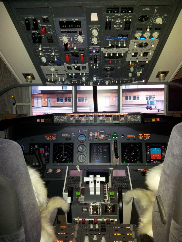

I'm buiding a flight simulator and I want to make some instruments that will look as though they are doing something.
The idea is that when I throw a two pole switch the servo will, (slowly) move a pointer to a given point. Then when the switch is closed again it will move back to the start position.

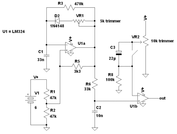

I'll try simulating a circuit to do this using a quad comparator/opamp IC and get back to you; hopefully later today.
Here you are, neighbour.:)
The circuit generates 5V servo-control pulses with a repetition period ~ 30mS. Pulse width increases over a period of ~ 10 secs when the NC switch is opened. Pulse width starts at <1mS and ends at >2mS.
VR1 and VR2 set respectively the range of pulse widths and the initial pulse width, but there is some interaction between the controls. The 10 sec period can be increased by increasing C3 and/or R8.
I've attached the .asc file in case anyone wants to run the simulation.

Thanks Alec, that's most impressive and something I would never have even though of... leave alone created ;)
As someone relatively new to this side of the wire, I assume that the servo input is attached to the output from U1b and the positive the 10K trimmer, negative going to ground. I understand that the servo is powered when the NC switch is opened, does it return to rest when the switch is closed again? :confused:
Again excuse my ignornce but what program do you use to simulate these circuits?
In case you're interested I've attached an image of the monster this is going to be used for.
Kind regards,
Joe.
If V1 is a 6V supply (I chose that arbitrarily as you didn't say what supply you intend using for your sim instruments) then U1b will provide +ve-going pulses of about 5V (the LM324 output is always a volt or so below the +ve supply). That could be the signal input to a standard modeller's servo running from 5V (four NiMH cells). I hadn't considered where your servo gets its supply from, but if it's happy running from 6V then the V+ at the top of VR2 should be ok for the servo V+ and circuit ground would connect to the servo ground. A 10uF (or greater) capacitor (not shown) should be connected across the battery, and a 100n cap (likewise not shown) connected across the + and - supply pins of the LM324 close to those pins, to absorb voltage spikes.
I also hadn't considered switching the servo on and off. Unless you're very concerned about current drain you can leave the servo continuously on while the circuit is powered on. With the minimum pulse width < 1mS the 'home position' of the servo will be at one extreme position of its travel. When the switch is opened the servo will move slowly to the other extreme (or some fixed intermediate position depending on the settings of VR1 and VR2). When the switch is closed again the servo will move rapidly back to the home position (to slow this return down would need mods to the circuit).
LTSpice. A free download from Linear Technology. Used by many members of this forum. Recommended.
Edit: Nice pic. I'm envious. Have those cats qualified as pilots yet?
Thanks again Alec for the detailed explantion, I'll get some LM324s and get it onto a breadboard.
I guess the fluffy covers need an explanation. I made the mistake of mentioning to the wife that in reality these seats are covered in sheepskin, (that's a fact if you don't beleive me have a look on airliners.net). So the wife in her kindness bought me these fluffy ones for Christmas... what can I tell you! They have to stay.. :-)

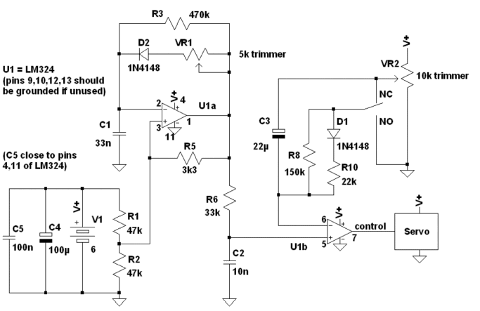

I've revised the circuit to allow better control of the servo speed. R8 determines the speed up the scale from the home position; R8 and R10 in parallel determine the speed back down to the home position. I've also included the two caps (C4, C5) I mentioned above, and the pin numbers for the LM324. Note that only two of the op-amps in the LM324 quad package are used here. The other two (unless used for another instrument) should have their inputs grounded.

Thanks again Alec, I can see you've invested some time in my problem. I've ordered a couple of LM324s when thay arrive I'll give it a go.
