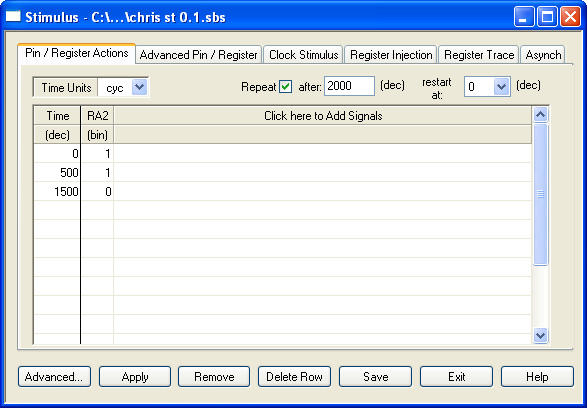

O.K. ,when I go to the restart box the drope out menu appears and it has only two values 500 and 1500 so, how did you select "0" because the value (0) must be in the drope out menu but as I said it (0) is not there. If you still don't get what I'm referring to then tell me how did you make thumbline of the whole stimulus window because I don't know how to do that otherwise I would have sent you a picture of mine stimulus window which I hope have served better, so please tell me how to save stimulus window in picture (JPEG or any other) format so as to post it on blog (just as you did to explain me), I hope this will be understandable.

Mine one does'nt have "0" so, I did something awkward, I have added 0 in time coloumn and for this 0 time I set RA2 to 1 and then I have 0 in the dropeout menu..........., oh god I can't go more easy than this in words ,Mike please tell me how did you attach the picture of stimulus window in your last post (I know how to attach a picture, but don't know how to copy an active window as a picture)

O.K. so this is what I have done to get "0" in restart, is it right to do so?
And the simulatio still does'nt work, after doing whatever in the thumbline I clicked apply then svaed the workbook, so this supposed to work.

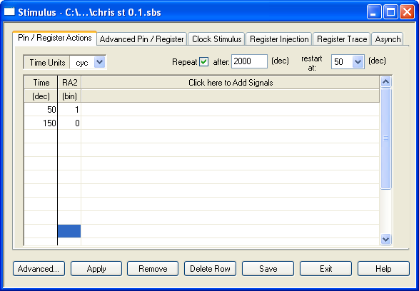

Hey ! that works , 500 and 1500 were too long period ( though I should have some patient, sorry for that)I reduce them to 50 and 150.:)

I guess you were using single step (F8). If you set a breakpoint as shown below, by double clicking in the grey border, then you can press f9 and the program will run until an interrupt occurs.
I know that but, pressing F9 with a break point runs progarmme only for first interrupt(as it should be) and then when I press agin F9 to cross over break point the whole MPLAB gets hang, only animation runs good but, that takes too much time.
It shouldn't do that, it should stop at the breakpoint every time you press F9. It might be worth downloading and installing the latest version.
Does it now work on the hardware. A good way to generate interrupts is to turn on the WPUs (WPUA=2 and OPTION.7 = 0) and then just ground the pin. The debounce problem shouldn't matter, it will just jump a few counts.
