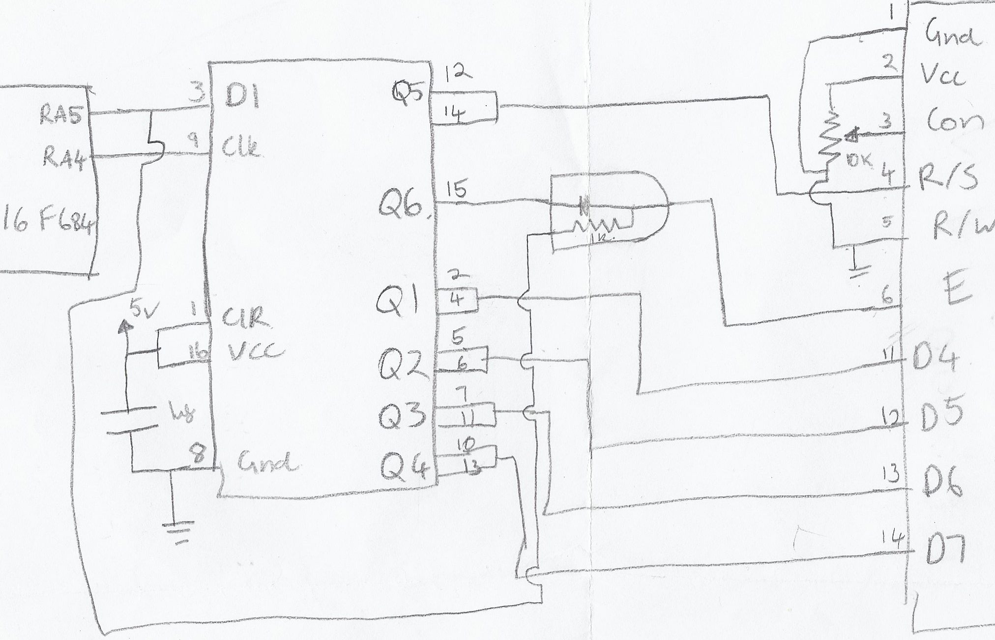

Hi
I have built a simple LCD driver circuit using a 6 bit shift register (6x D Flip-Flops). However the timing of the clock pulses is acting very odd!!
If I put the data onto the serial in pin and clock it within 3 µs the screen displays jibberish, if I wait for a total of ~18 µs it works perfectly.
Why is this so?
All of the pulse widths are above minimum values as stated in the data-sheet. So it is not being over-run.
I apologize if I am being a bit vague, but I just have no idea where to start.
Tom
What is the source of the clock signal you're using to drive the flip-flops? Is it clean?
The clock signal is just the MCU pulsing the clock pin high, for 1 instruction cycle (2 uS), then back to low.
When I checked a signal created in the same way, just in astable mode, and it was nice and clean.
Tom

Hi
The LCD data-sheet says that it is driven by a HD44780 compatible chip.
The enable pin is driven with a AND gate (diode and resistor), it gets one high from the shift register and one from the data pin once it has finished inputting the data.

I will go and scan the schematic now.
Tom
Hi
Here is the rest of the LCD code....

and the schematic is attached, sorry for the dodgy quality.
Tom
Um.. sorry to say that it all looks ok to me...
The only LCD timing parameter that is close to the magnitude of your instruction cycle period (what, 1us?) is the minimum enable period (which is 1000ns = 1us). The shift register should have no issues with any clock rate the pic can give it.
From the working & nonworking code snippets you posted, it looks like data takes a little while to settle or something. Anyway, sorry again, I can't provide any insight whatsoever.
You don't say what processor you are using.
Can you possibly post the assembly code that the C compiler produces?
I suspect that

Ahhhhhhhhhhh, You might be onto something.
I'm using a PIC 16F684.
