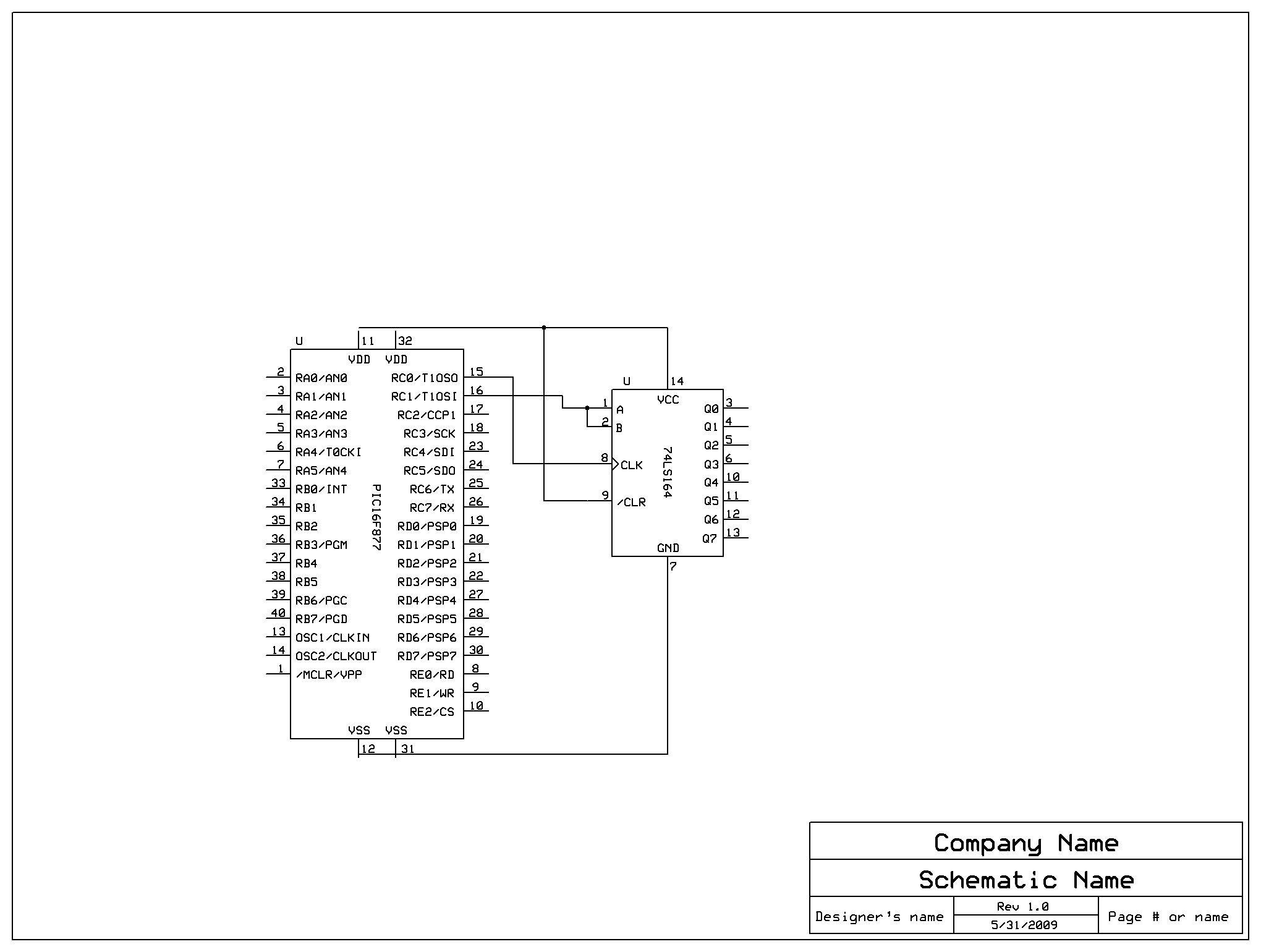

To use a 74ls164 you shift data and clock it in the clear pin high if the clear pin is low it will not clock in. This video is with a 8 pin 12f683 and 3 74ls164 and 105 leds you can see it works. I just used the clock and data hold clear high [embed]http://www.youtube.com/v/ShmWUE1sRBM&hl=en&fs=1[/embed]
hi be80be ,
okay , i getting clearer what you mean , does it mean that i must hold the data pin and clear pin high all the way so that the clock can be pulsed into the 74ls164 ??
Two pins control the data the clock and the data pin you shift data in and clock it in till you load all your data but the clear pin has to stay high while this is happen your clear pin has to be going low if that happens no new data will load just move the clear pin to vdd add try it that way holding it high and load you code like you have it

Here what i'm saying hook your 74ls164 up like this and use just the data and clock to shift your data in I tried your code in mplab sim your only sending data out one time and it all looked right. It's shifting it out one bit a time and the clock was right and the clear line went high like it should.

hi,be80be
you mean is i should put the clear pin high?? or make clear pin high is the mistake i did??
can me have a example of the code to make it send out other continuous data ??
thanks for helping me so much ..
Regards
TK
You have changed your code to like what Pommie showed you. Post your new code what your using and I help you get it going. Like I said I ran what you had posted And the only thing it wasn't doing right was shifting the data . But I think you fixed that if you added what mike told you to do. Read this it shows you how it all works PIC microcontrollers : chapter 7 - Examples. It's about using shift registers. You shift data like this.
1. load bit to to RC1
2. clock bit out
3. load next bit RC1
4 clock bit out
You keep doing that till you have loaded and shifted say all 8 bits
What the code you posted is doing is just loading the same thing over and over.
There will be no change.
So if you change your code post it and lets look at that

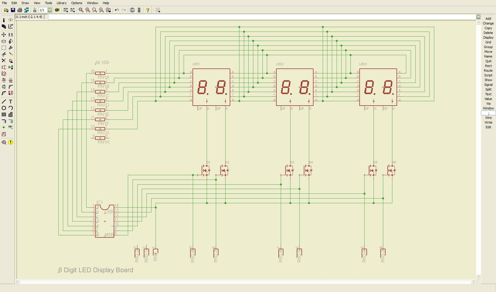

I've just got my 6 digit display working when driven by serial to parallel data conversion.
Code / schematics attached in case they can be of any help or interest to the OP. The code is probably a bit long winded - only just got it working and haven't spent any time trying to compact / streamline it yet.

Thanks for your schematic and coding , i will go into it as soon as i try out the 1 be80be gave me =)..it's a nice 1.
