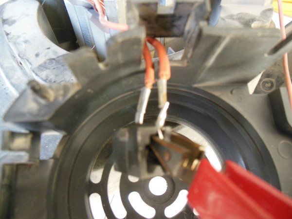

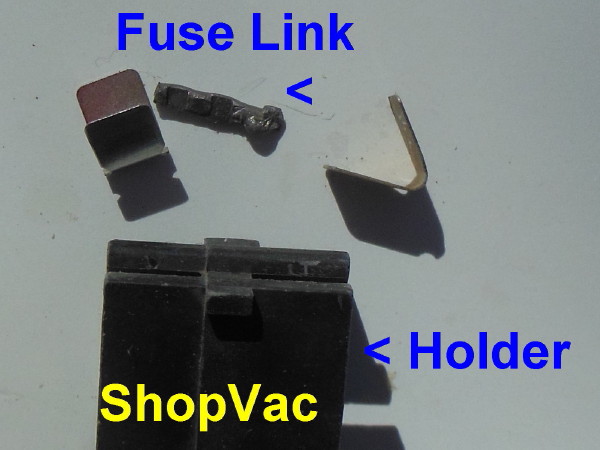

I’m looking for something to replace this fused link. I fixed my Dishwasher with a thermal fuse from Radio shack and just didn’t use the Plastic holder. I’m now thinking about doing the same thing for this, but I’m not sure what amperage or temp range it is.
Any ideas?
Update I just noticed a label on the Vacuum that says 11 Amps, but I don't think that's what I want.

Don't confuse a thermal fuse with a current fuse.
The thermal fuse "kicks" out at a preset temperature, not an over current. Their current rating is like that of a piece of wire, not a value at which they "blow"

Thanks, I figured it out after I got to radio shack and read the package, but I bought it anyway because it was rated for 10 amps. So I figured it just might blow out if it goes over that.
Anyway I went ahead and installed that thermal fuse. I decided to drill out the holder to fit the fuse and soldered it inside. This way I can plug the holder back in and insulate the connections.
It’s back together and working, but I don’t know for how long. I guess time will tell. In the meantime I'll try to find another fuse link. the original was just a round filament about the size of a #12 wire.
