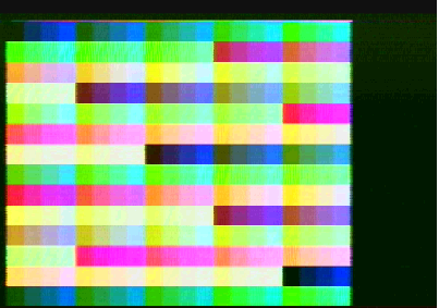

Show Image on TV and Color PAL with AD725
THat sounds a bit careless about calibration.
RGB in maximum input level should be 714 mV p-p. WHat is yours?
What is input noise level during HBI?
4x frequency error?
etc etc.
I would guess 'Horizontal Blanking Interval'?
Exactly correct ... thank you so much ... my problem solve with your help
all friend thank you for reply to my questions...:)
In the PAL television standard, the blanking level corresponds to the black level, whilst other standards, most notably NTSC, set the black level slightly above the blanking level on a 'pedestal'.
There is both a Horizontal and Vertical Blanking Interval.
no need to thank me, just send clear pictures.
