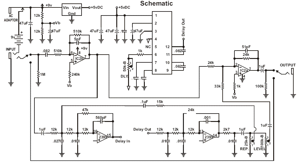

I've built the attached circuit and it works fine. The only problem is at the output, a low Shshshs sound is there, if you talk into the input or not.
What can be the problem. Please help me.
Sorry for not using the proper AUDIO terms.

Your schematic diagram is incomplete, missing useful information. For example, what is the part number for the delay line IC and what is the part number for the unidentified op amp?
Also, I don't quite understand the point of the 9V battery. It appears to subtract 9V from the 9V supply rail to insure that the ring connection of your jack is at zero volts. That can't be right, is it?
It seems to use a microphone that is not the normal electret type. A dynamic microphone? They normally feed a low impedance amplifier, not the 1M in parallel with 510k like this preamp.
The Shshsh hiss might be caused by the unknown input opamp.
The circuit has the input opamp feeding directly into the output opamp without any lowpass filter.
Yes, it's a guitar preamp with reverb - no idea what the delay chip is, but I would expect the noise is from the BBD delay device, as it shifts data through itself.
sorry guise ! i forgot to put the IC number it is TL072. And i used a dynamic Mic as what Audioguru expected. Jumids circuit it is simmilar to mine but i am not using it for guitar, it is for speaking/singing only.

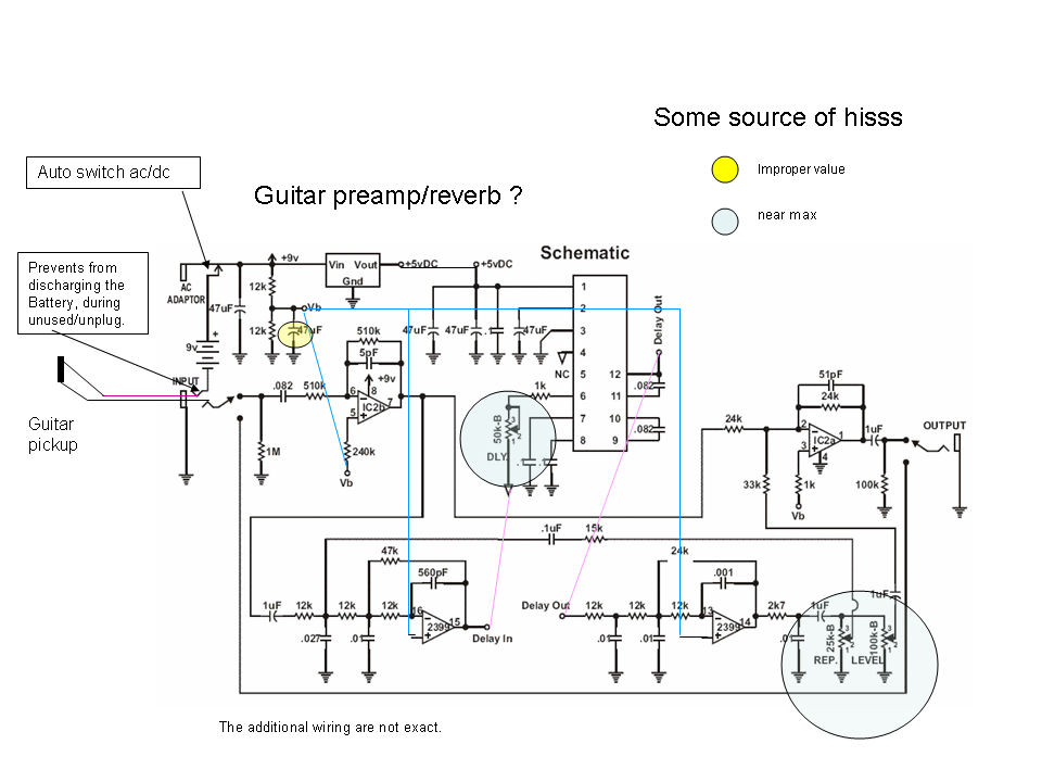

hi aljamri,
It was not similar, but it was your diagram/circuit and add some wiring for the completeness of the circuit, sorry for editing your diagram. Those circle "mark" are base only on my experience during repair works.
I agreed to Nigel Goodwin's idea.
Another source of "hiss" are PCBoard, lack of grounding/earth and metal shield, be sure to used good shielded wire from mic to preamp to amplifier.

If you're using it with a microphone then add a mike preamp to the front end, it's not suitable for mike level signals, and that would be a major reason you're hearing the switching noise from the BBD - because you're operating at MUCH too low a signal level.
As we've suggested, it looks more like a guitar circuit, with actually zero gain, and about 400Kohm input impedance.
Actually, after a few seconds thought, it's actually a guitar reverb foot pedal - switched by plugging the quitar in, and with a bypass switch operated by your foot, and a gain of zero so it doesn't alter volume when you switch.
I didn't notice that the circuit has no gain.
It certainly needs a microphone preamp that is designed for a low impedance dynamic mic.

its 2399 ( Echo processor )
no it is the whole circuit supply, and wherever 5V required it comes from the 7805 regulator.

I didn't know they still used BBDs for delays, I thought digital signal processing units are more common nowadays.
The PT2399 echo IC is not a BBD. It has an ADC, digital processor and DAC.
It has fairly low distortion and low noise.

It's a Bucket Brigade Device, but now you've given us it's number we know it's not one of those.

but as i said guise, it is working fine, just the little hiss which prevent it to be perfect, what can be adjusted even as trial step

Like I said (twice), it's a GUITAR effect pedal, you need to run it at a MUCH higher signal level than a microphone provides - add a preamp to the front, and turn down the gain on what it's feeding.
