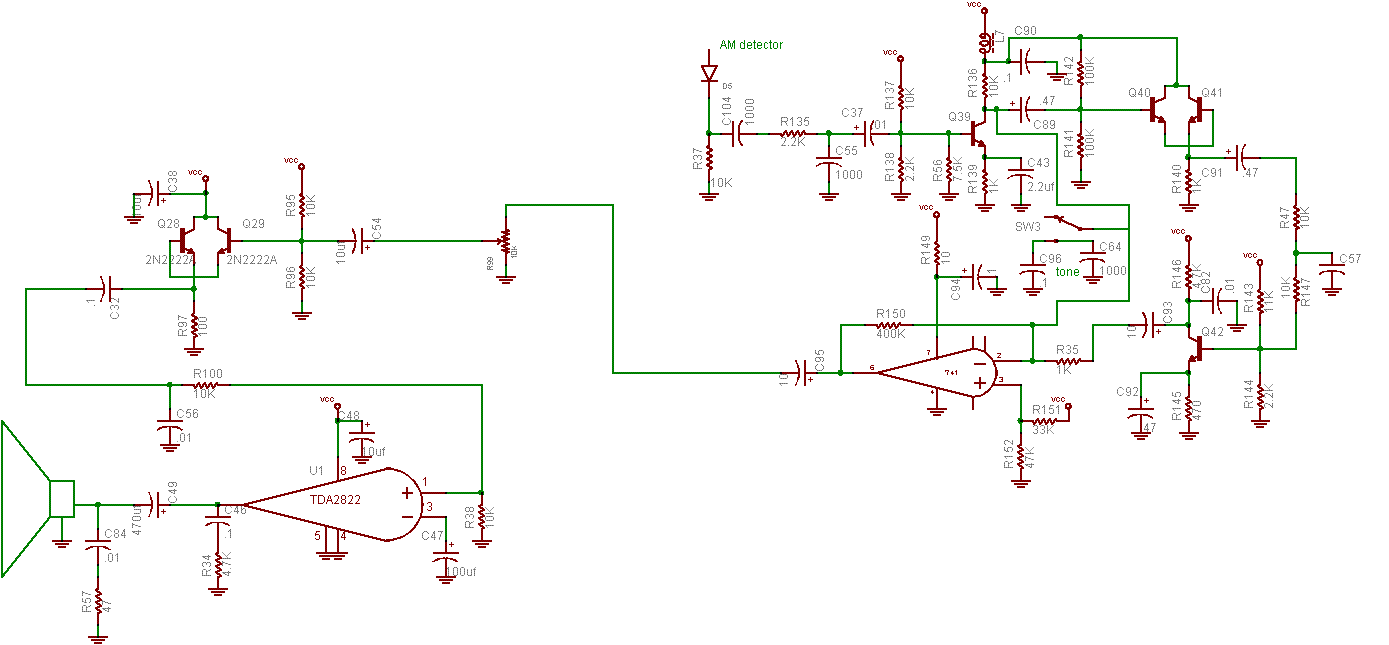

OK this is it and you were dead wrong. That chip does need a driver or it isn't loud enough. You see I changed it to a current amplifier and killed two birds with one stone. I got the extra drive and matched the Z.

Perhaps you would care to go through the design of one of the stages?, it's reasons for been there, and how (and why) you calculated the values.
Actually, I would love to. I want to hear your reasoning behind what you think should go there.
OK, we'll go through it a piece at a time.

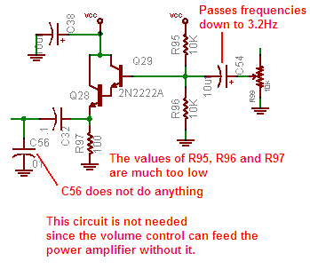

Q28 and Q29, why a darlington?, and why there at all?.
R100 and R38 constitute an attenuator, and you're only getting half the signal you started with - so you're making a net loss for no reason.
Connect C54 to pin 1 of the output IC, and replace R38 with a 47K - you're now no longer making that loss, and you've saved two transistors, four resistors, and three capacitors (and are getting twice as much gain). By removing those parts you're reducing noise and reducing distortion.
The output of the opamp is a low impedance, and can easily feed the power amp through a 10K pot, and a 47K input resistor is high enough to have no significant effect.
I won't go forther until you address those points, but you still don't have an electrolytic on pin3 of the opamp? (we'll discuss it's odd connections later).

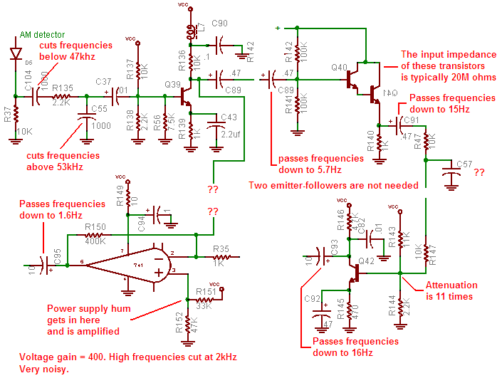

I went through the circuit and found that the value of the very first audio coupling capacitor C104 is so small that it attenuates all audio frequencies about 64 times. It cuts the low frequencies and makes the sound tinny.
There is a dead short from the collector of Q39 to the input of the 741 opamp.
The values of all coupling capacitors are so high that very low frequency rumble frequencies are passed and amplified.
The darlingtons are not needed.
There is a lot of attenuation which requires too many amplifier stages.
And some of them (C54) are backwards and will fail/leak prematurely.
And that op amp symbol is just plain funky looking.

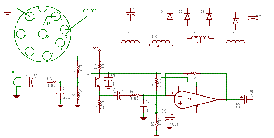

I just found the problem. Pin #1 is the ground...lol. I had the other two right for the PTT and mic hot. It has a beautiful audio. :)
Here's the audio for the sure mic.

The op amp has a high input impedance so I do not see the purpose of the emitter follower proceeding it.
Your audio coupling caps range from .47uF down to .1uF then up to 4.7uF. I don't understand the logic for that.
I put the connector for the mic in this one. The extra parts will be the balanced modulator.
Filtering. But remember I had the wrong ground originally. I'm just gonna leave it and move on. It looks great. I got allot of stuff to put in this yet. I realized I just ordered some Amidon T-80-02's that I can make a wholloping BFO out of. If I pad it down and keep the variable cap away from the can, I can make it very stable. Then I could just buffer it into the balanced modulator....should work!
With a .1uF cap your filtering your audio, at 1kHz your cap Z is about 1.5K
