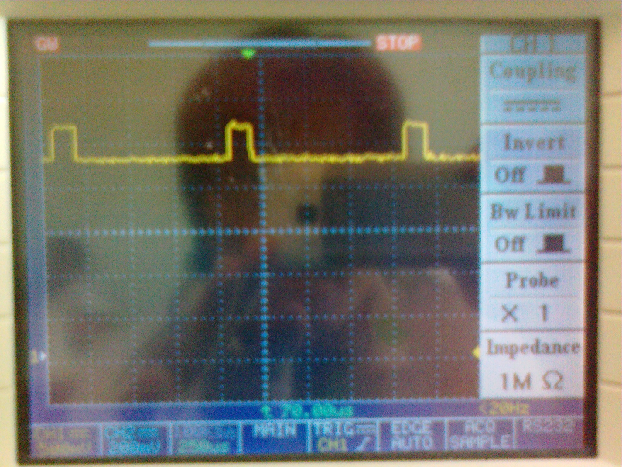

btw attached is the scoped output signal from the sensor. upon measurement today, there seems to be a square wave at occasional intervals. Datasheet does not indicate that this occurs =/...is this expected or is there a problem with the sensor..? the amplitude of the square wave is approx 300mV..

Looks strange. If the analogue output should just correspond to the distance it shouldn't be there. I checked the data sheet and I think you should see a continuous signal. Check if this square wave exists in the power to the sensor as well. Have you any high current flowing in the system?
Those pulses are spaced 4 divisions apart. What is the time/div, 25us?
I briefly looked at the GP2Y0A21YK and there is some indication that it takes large pulses of power, and is recommended to have a nice hefty capacitor near it.

you were right! the power supply was indeed the culprit. everything is working fine now..THANKS=)
I did just that and the signal stability improved. THANKS=)
