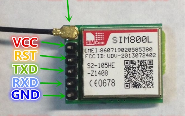

I'm working in a project where I have a MEGA2560 and a SIM800 module.
I basically followed the guidelines in https://vsblogs.wordpress.com/2013/11/28/tcp-connection-over-gprs-using-sim900-and-at-commands/ to deal with the SIM800 module and the connection.
The thing is that everything works perfectly for a few days and then the module stops registering in the network. I replaced the SIM card for a new one and it starts working again and after a few days same problem. I get a registration denied error (AT+CREG? returns +CREG: 1,3).
I used 3 different SIM cards from 2 different phone companies with the same result.
What's weird is that if I install in my cellphone any of the SIM cards that are not registering with the SIM800 module, they register perfectly well and I can navigate the web with no problems at all. If i take them back to the module, they don't register.
Also, the weird thing is that the module is supposed to register on it's own at power up or reset without any intervention from my Arduino code. The module tries to register, I see the process if I monitor it via serial port from the PC but registration is denied over and over.
Any ideas?
The attachment shows the module I'm using

Is it a stolen or fake SIM800?
All GSM/GPRS modules have to tell the network their IMEI to work, and it could be that it takes a few days for the network to check the IMEI number against some database.
If it is a fake or copied module, their may be lots with the same IMEI, which will cause all sorts of problems when they try to register.

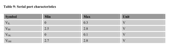

While your main problem does sound like a network limitiation when used on the Sim800 module, how have you connected the Sim800L RX pin to the Megas TX pin, a direct wire ?
The spec sheet for the Sim800L on a bare module like these is 2.7v, so a potenial divider or similar is needed.
It does seem to work at 5v , but I did not keep it at that for long after I realised the sellers info of 'TTL compatible' is wrong for these modules ( not the larger 800L EVB modules ones which has logic level shifters)

Now I have more info... after testing problematic SIM800L module (measure voltage on antenna out - with germainum diode....). Than compare with OK module, bad module don't have any voltage on ant. connector. OK module work fine when start -ON module or make call... voltage increase... Also I was talk with engineer from tel. company and he find that is all ok with imei and problem is in my module.
It sounds like the module wasn't made properly and it has failed after a few days. If the antenna isn't properly matched, you will get a bad VSWR, and more power than expected will be reflecting from the antenna, which can over-stress the transmitter.
Yes it is possible, but i don't have VSWR meter. I was use PCB ant. with S.W.R. 3 @ MHz & 880~960 <=2.5 @ MHz 1710~1800 it s from aliexp. **broken link removed**
Does the IMEI printed on the module correspond to the one that reads out electronically? The command for that is probably AT+CGSN.

HELLO I am using sim800l...
The imei printed on my board is different than as I get the imei number from AT+CGSN command.. What does it mean... My module is fake or something....?
