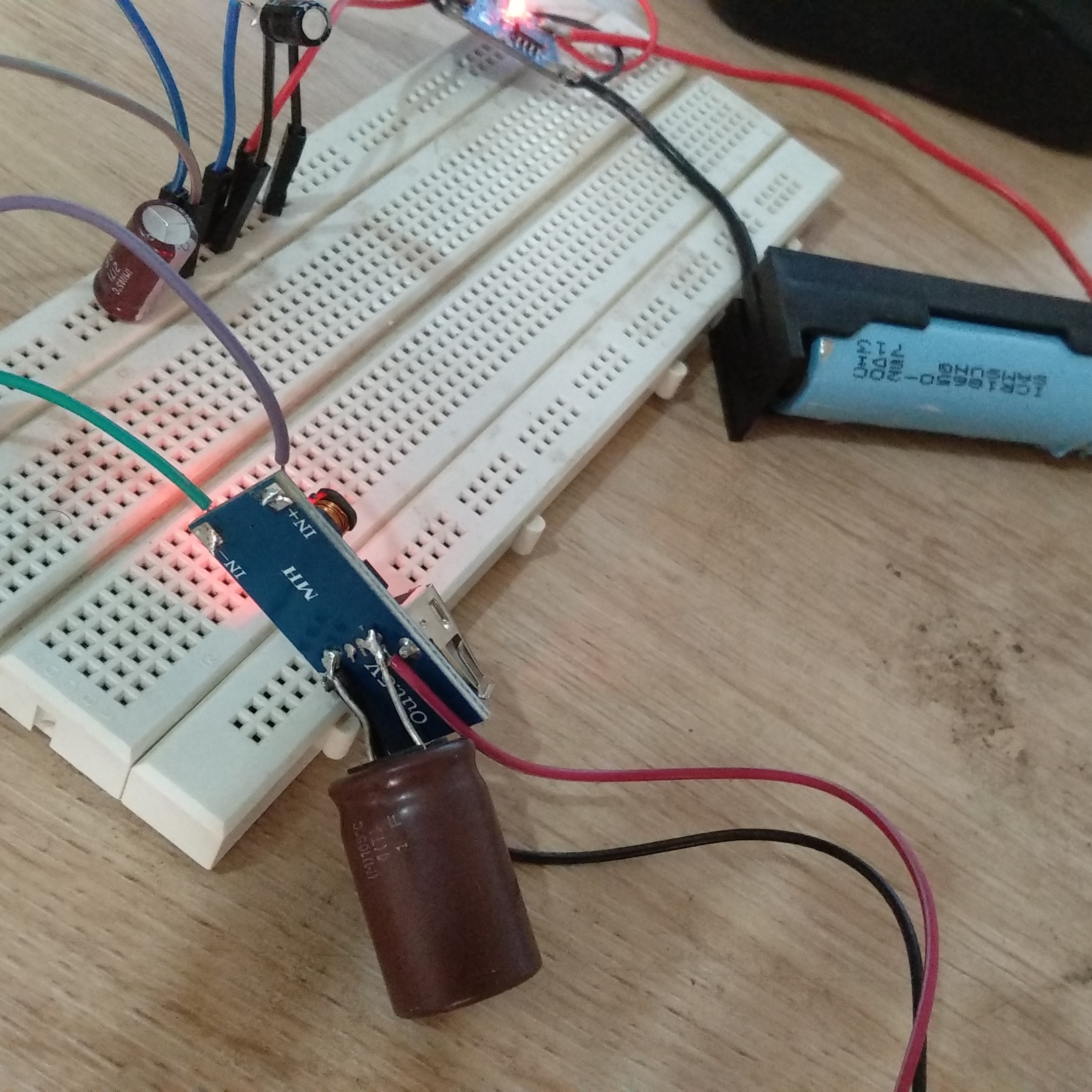

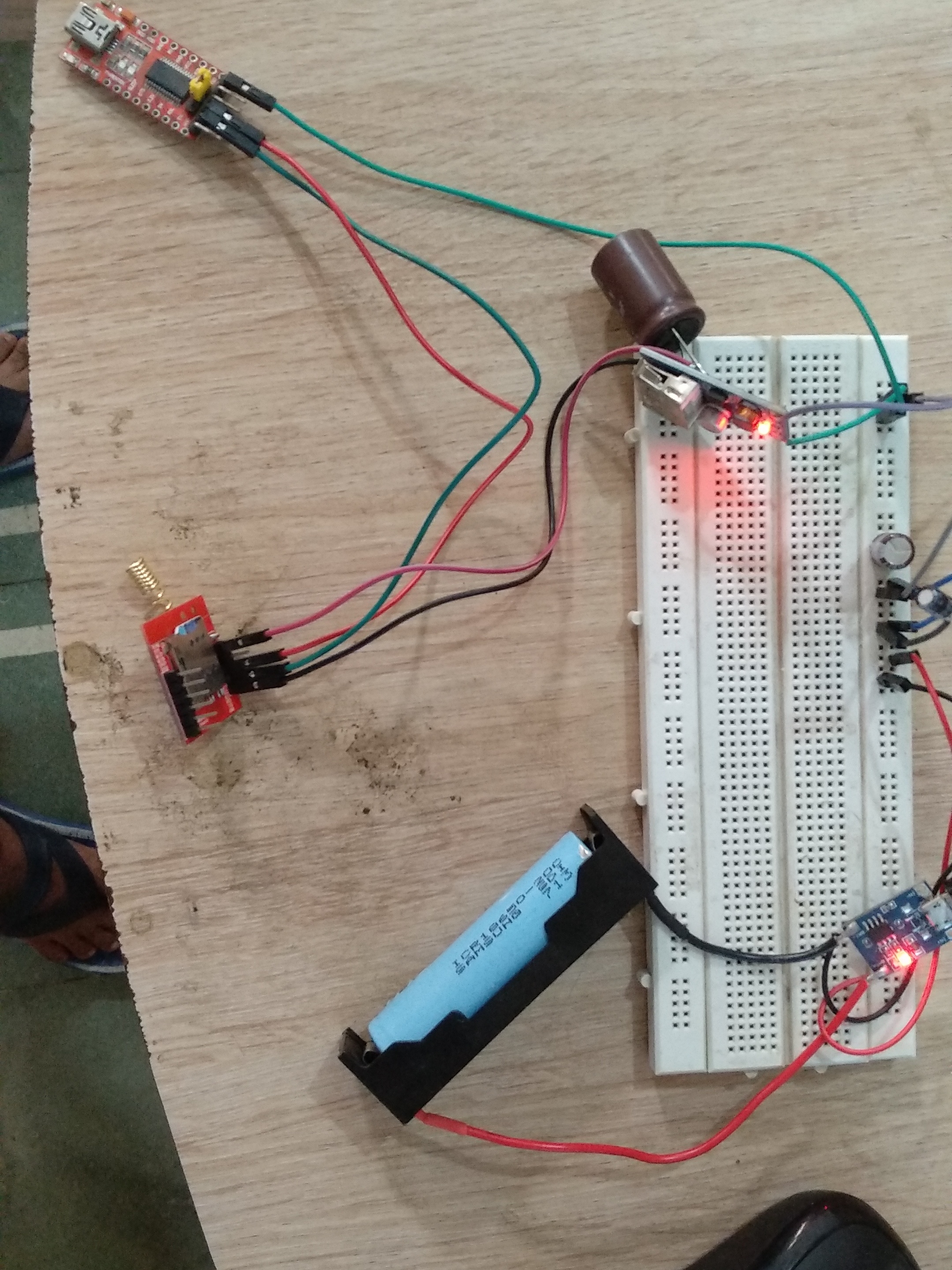

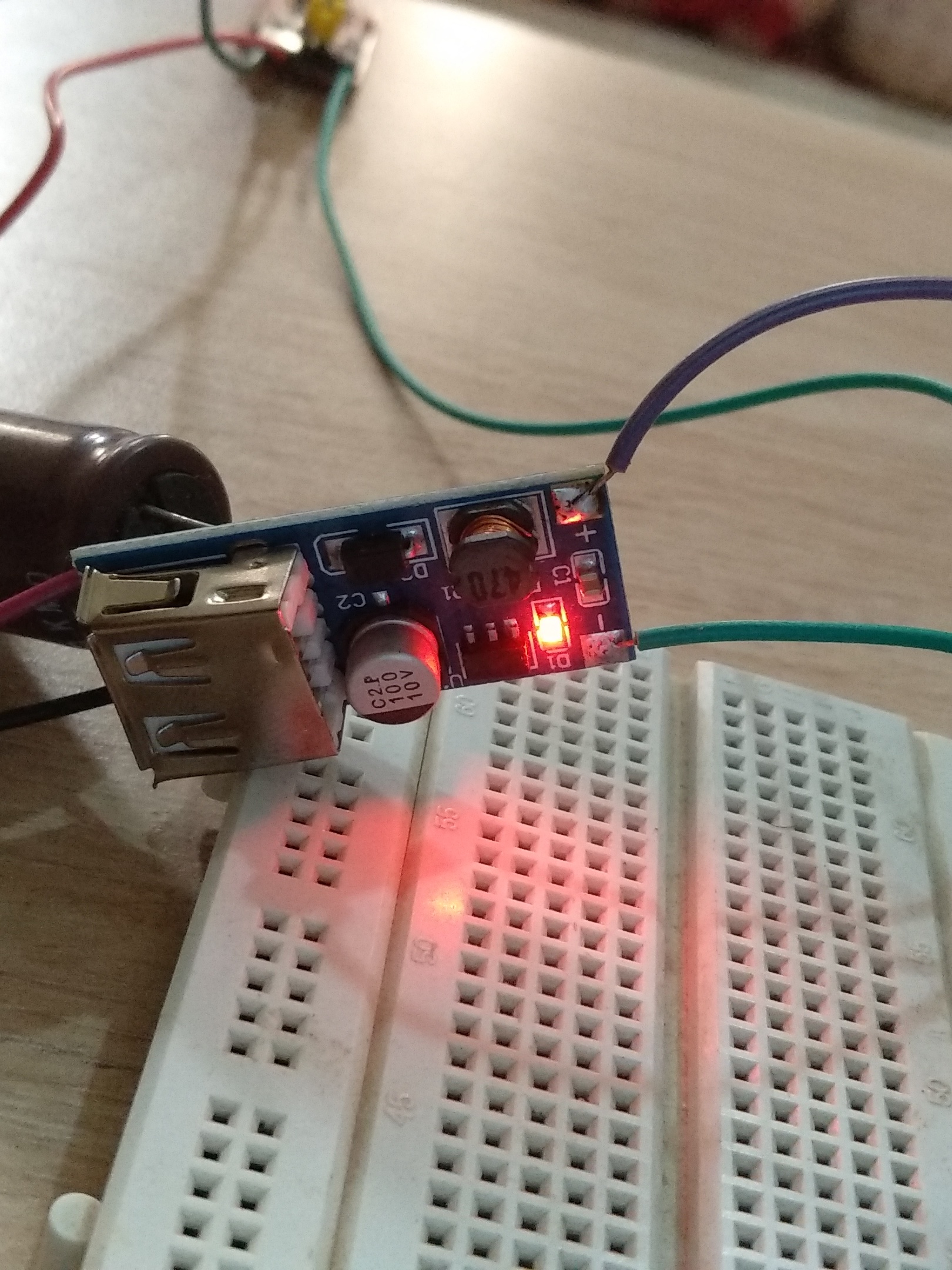

Thanks for quick reply...
I put the module permanently Connected for 1 hour ... And +CREG: 0,3 and network led blinking at 1 sec Continuously... Here I attached photos of my set up.. I gave 5v supply to sim800l board and was working perfectly few days ago... I am using 18650 battery and 5v booster as supply...

Don't use the 5V booster, you're probably killing the SIM800 by using that, the 18650 direct to the SIM800 is all you need. Check the SIM800L datasheet for it's voltage specifications - it's designed for a maximum of 4.4V, and specifically for a direct feed from a Li-Ion battery.
And make sure your FDTI module is set to 3.3V, it looks as if it is though.
First, make sure about the power supply and stability by adding a large capacitor. Then take care of the antenna. If your problem didn't solve. Replace your GSM module.
