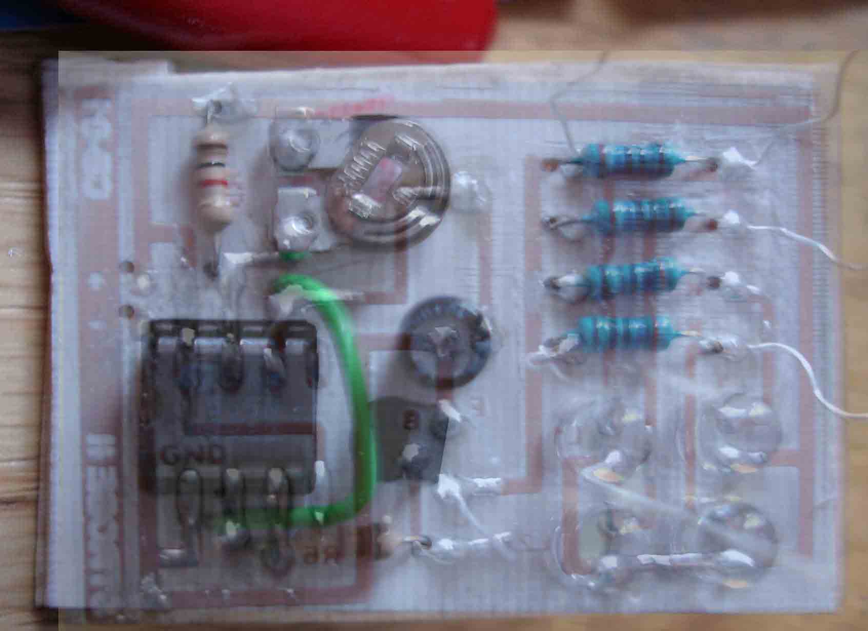

simple 555 4-LED Strobe light PCB problems.
I want to make another version, but its alot of effort to make one, drill it, solder it, just to find out that youve cocked up somewhere along the line!
I have flipped the images, and overlayed them. Its quite confusing:eek: but i think that it shows how its all connected.

Checked your pcb againsnt your recent pix, it all looks OK?
Just a couple of suggestions, cut off all the component surplus wire under the pcb to prevent further problems.
Check the polarity/condition of 4u7 cap.
If it still fails, send me a PM, so we can organise for it to be sent to me.
I'll fix it FOC as you are in the UK.

I don’t know from which side you see to the PCB, the easy way to check it right or not (is in the case of your design PCB) simply check the positive & negative supply to IC -555
If it OK, means you mount the component OK. Next come to U problem.
1) First of all connect pin 5 of IC to ground through ceramic disc capacitor 0.1uf.
2) Second you should to change the 100K variable to 1 M ohm than you can get a good fleshing rate.

Im new here and new to electronics, but I've run into this problem before. What my experience has been is that the 555 gives out a sine wave form, not a square form. What that means is that it doesnt go all the way down to 0v, so there is still some residual power going to the NPN, causing it to allow current to flow through.
To solve this, you need to up the resistor value from the output pin. I have had good luck with both 16k and 18k resistors, as used on different circuits. Also, you will need to have another resistor connecting from post resistor to base to the emitter. This resistor needs to be about 10x the pin 3 to base resistor. This also helps drain the residual energy.
On my last flashing LED project, the LEDs were supposed to flash, then switch sides, flash, switch sides, etc. The no longer flashed, just changed sides. I tracked that problem down to not having the base to emitter resistor in place.

You ask in what respect is my solution to bitem2k's problem still valid. I would ideally point you to my own completed LED projects. However absent that option, I guess I'll have to make a logical presentation.
I probably need to give a little background. For the last 3 months or so I have been dealing with flashing LEDs. It is in part a pet project to see how efficiently/cost effectively/etc I could make flashing blue LEDs that would be suitable for police patrol work. I have made flashing LEDs using 555s and a set using a 555 / 4017 combination. In all of my versions I have used NPNs and in one style I have used PNP transistors also.
Now, despite my very regrettable goof in calling the output sine instead of square, the solution to his problem is not bothered. This is because it boils down to controlling the transistor. The obvious problem here is that the transistor is not turning off. What this simply means is that there has to be some voltage getting to the transistor. As you are no doubt aware, it takes very little to turn the transistor on. The solution that I have found in my own work is to put a higher value resistor in-line. W/ my 12v work 16k works well between the output and the base of the transistor. Another resistor needs to be added between the base and the emitter of the transistor. The recommended value and one that works in my work is 10x the output to base. BTW, the resistor goes after the output to base resistor.

The only problem with your post was calling it a sinewave, the resistor between base and emitter is standard practice, for the reasons you stated.
Nigel Goodwin,
It appears from the pictures posted by bitem2k that his project lacks that resistor.
Clayton
It would appear that the reason my circuit doesnt work (most of the time) is because I foolishly omitted the decoupling capacitor.
