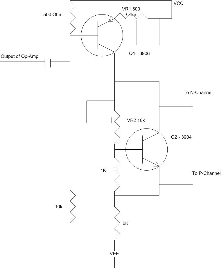

Your second circuit with the feedback connected properly to the Mosfets has the Mosfets idling at a very high current that might overheat them.
At +/- 30V the current idles at 1.0Amp. Even when I blast the speaker, the current from the power supply does not exceed 1.3Amperes. The Mosfets produce a lot of heat. I attached them to separate P3 CPU heat sinks with fan so that keeps them at ambient temperature level.
I will try the negative feedback with C1 removed as you have suggested.
Wow that's inefficient.
I looks like you've got it biased in class A which has low crossover distortion but it runs very hot.
Looks like you found the "other" lead :) Removing the cap shoudn't be a problem, becuase you're FET's are both turned off at the crossover point, but just leave it if it makes you feel better LOL! Glad you have it working well, after all your ears are probably pretty good distortion meters Heh!
Hmmm.. I haden't read all the way through the thread when I said your FET's are off during crossover. I wonder why that is? Seems they should not be conducting at idle
When the supply was plus and minus 12V both Mosfets were turned off at idle (class-B) which causes horrible crossover distortion.
When the supply was increased to plus and minus 30V then both Mosfets conduct 1.3A at idle (class-A) which causes them each to heat with (30V x 1.3A)= 39W.
A class-AB amplifier has both of its output transistors conducting a little at idle for very low distortion and low heat. The idle current is adjusted then is temperature controlled by a diode or a transistor.

I would try to replace the two 1.2K resistors with a Vbe multiplier with variable adjustment, and adjust to a good compromise between sound quality and quiesecenent current. I've build amps with very good results using this method. If you can't find a schematic, I'll try to scrawl you out for you. When you try it out, turn the bias all the way down, then while monitoring the current, slowly turn it up until the sound quality is good.

Here is a schmatic of a Vbe multiplier. This drawing is for illustrative purposes only!!! I have not prototyped and do not guarantee correct operation. I have not done a detailed analysis, but if you want to try it, I suggest you build it on a bread-board by itself, and try to set it up before incorporating it into your circuit. To set it up, turn VR1 to a maximum value, and VR2 to a minimum value. Connect two resistors, about 1k each, across the outputs labeled To N channel, To P channel. Set VR1 for 0V at the junction of the two 1k Resistors. Then set VR2 for ~4V across the resistors. If that works, you can add it to your amp, but turn VR2 back down, and then back up slowly in your circuit.
The component values for this circuit are calculated, and not necessarily 'standard' values. Use values as close as possible. This circuit is experimental, and won't give the best results, but will hopefully demonstrate the principles involved. It may requre additional emitter follower or source follower devices to be placed before the output drivers. Sorry, I do not have a chance to prototype this circuit. You'll just have to play around with it. Getting the driver to correctly output the signal efficently required complexity. It would be a good idea to simulate the ckt if possible.
If you choose not to use this, you may just lower the value of your 1.2k Ohm resistors in your original circuit.

Oh one more thing, the transistors will only tolerate Vbe=40V. I Think you're up to about 80V total rail-2-rail now. Use Hi-Voltage devices.
