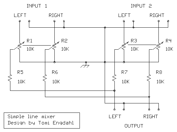

i found the digram below on the net somewhere, but i'm not sure if it will do what I want, and if i can put a decent colume control into it.
Any help Greatly appreciated

Yes, this is the best quality - without active elements. If You have enough signal - min.20mV - it work fine.
ok, thanks sebi - you say this is the best quality without active elements - does that mean that the quality would not be very good, but you couldn't get it any better without getting more complicated? Basically, is it worth persuing this method, or will the loss of quality be intolerable?
could I just replace the two dual gang pots with larger ones (e.g. 47K), to make an effective volume control?
also, could i just repeat the input part of the circuit several times, connecting them to the output (as shown in the diagram) to make a mixer that would mix several audio sources (more than 2)
lastly, on a 3.5mm stereo headphone jack, and on phono plugs, which connections are which?
thanks again
Tim
O.K., sorry for bad english... i want to say this is the best quality,because no contains any active elements.Transistors, IC-s, tubes have always generates noises, distortions, etc.The new and newer devices always better and better, but noises today also existiert.
Of course possible multiply this circuit for more channels, if You want use 47k potis, the serial resistor must be also 47k.

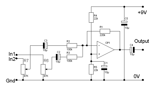

Here's a circuit for a simple mono two input mixer, using a single 9V supply. For stereo simply make two of them, for more inputs simple add extra pots (R7), capacitors (C3), and resistors (R2).
I've just made the values out of my head, they are extremely non-critical, I once built one to do a disco in about 30 minutes - using the first parts that fell into my hands!. My little brother who watched me do it, still doesn't believe it worked (even though he heard it) - perhaps my comments like "that's a pretty colour, I'll have that resistor" might have confused him :lol:
If you need a master volume control, just stick one on the output, 10K or 4.7K would be fine.

I know, i know, I can't do anything my self, but i still (!) have a couple of questions.
1, i always thought that the power connections on an op-amp had to be connected to +v and -v which would mean that you would need two power supplies, or do I connect the one connection to 0v instead of -v??

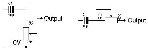

2, to make the master volume control, which of the two diagrams below is the best way to do it (or would they both work)
Again, thank you VERY much for all off your help, if you like I will let you know how I get on.
R4 and R5 generate a split supply (effectively + and - 4.5V), the positive pin goes to 9V and the negative pin to 0V. If you want to use a real split supply, simply remove R4, R5, the capacitor across R5, and connect the non-inverting input to ground. Then connect the -ve supply of the chip to a -9V supply.
I used a single supply to make it easier for you.
The first one, the other won't work properly, and is never really used as a volume control.
