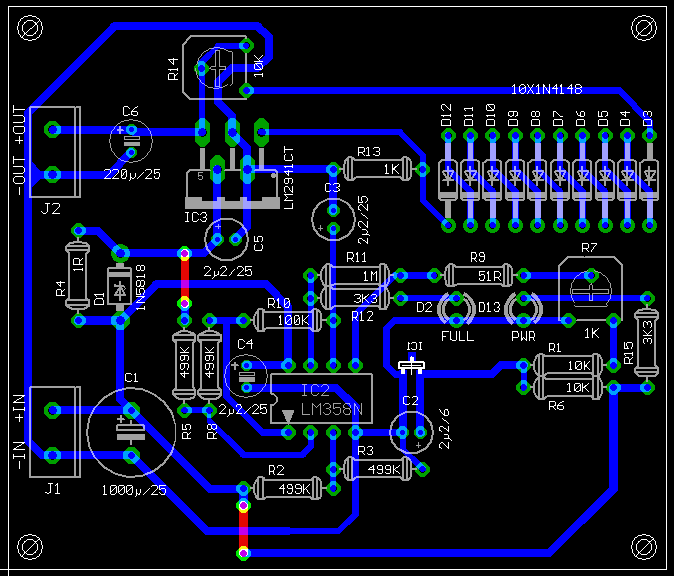

your circuits looks neat and simple.
Here's a neat and simple PCB design for it.
Very cool. Your PCB software is really fast.:p
It's not the software, it's the operator. :D
BTW, I suggest making a note about the LED types to use. They must be low current (2mA).
Since R12 (full charge) has a value of 3.3K I adapted R15 to have the same value (power LED). All other values are unchanged.

Boncuk, is there a way to print the PCB design without the parts overlay to make an etching pattern?
Just PM me your email address to get the Eagle files (schematic + PCB layout)

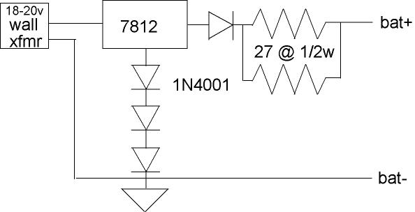

Battery Maintenance
Here's my flavor. While not as elegant as BHs', its' intent is not to charge but hold a battery over long idle times. Current record is over 2 years on a motorcycle that got parked & forgotten. Carbs were totally plugged, but the AGM battery was fine.
One wall wart & regulator can feed Several diode + resistor outputs (mine has 8). I've build at least 6 of these for friends' motorcycles & garden tractors. <<<)))
is this schematic can work for Simple Charger for 12V Lead-Acid Batteries
