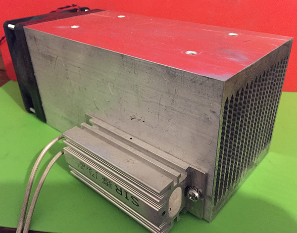

Well, one thing could be that is has a standing current in the output stage of around 25A or so, with continuous power dissipation of around 500W. It would need rather beefier output transistors.
If anyone really wanted to try it, I may be able to come up with a suitable heatsink. I'd only use it in winter when you need the extra room heating, though!
Thats a pretty buff looking heatsink!
I am miles away but I feel the heat and smell the smoke from the class-A amplifier.

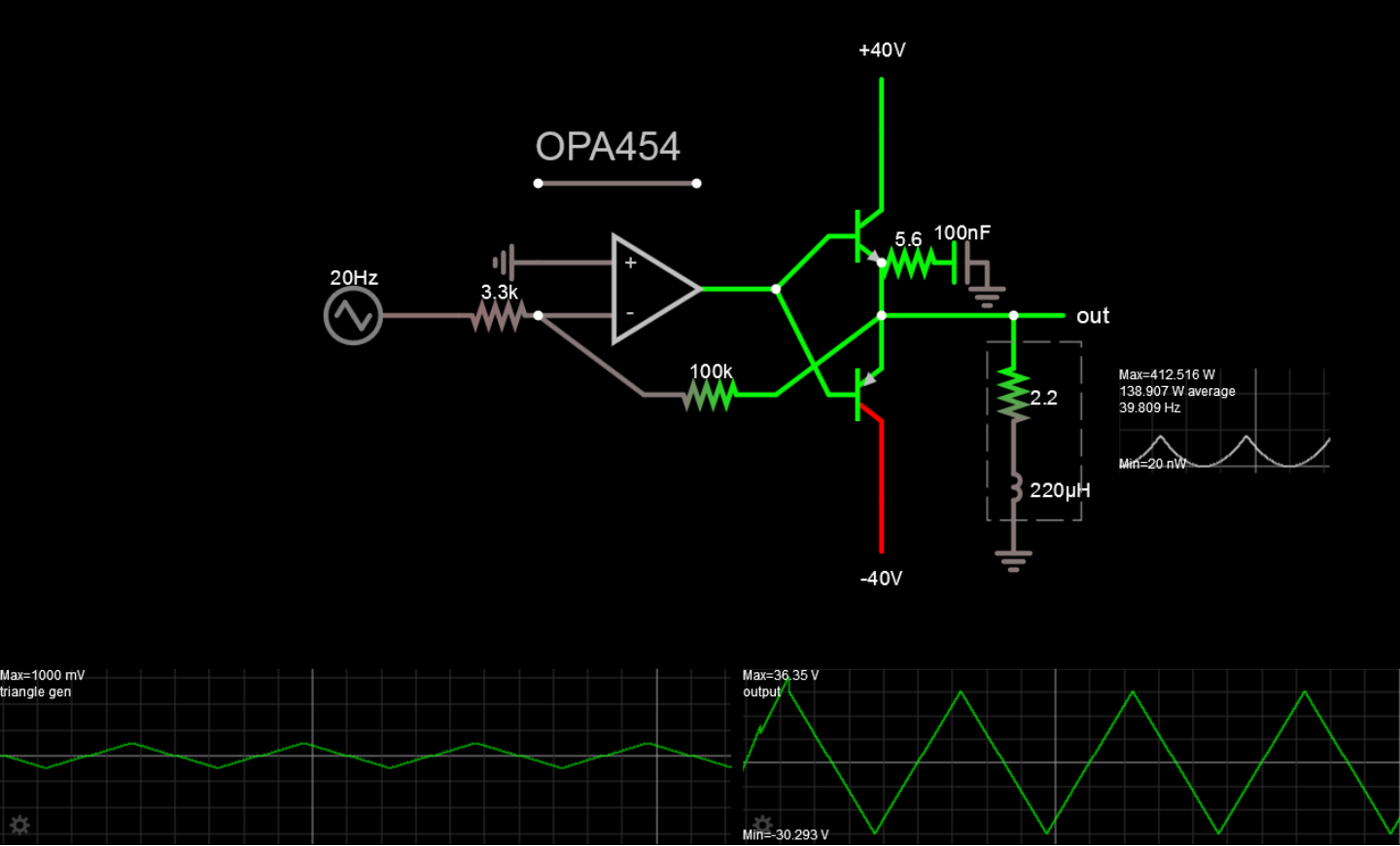

The opamp with an 80V supply driving T0-220 output transistors to maybe 2A peak will melt from trying to produce 2.6W into the transistors. The transistors also might melt trying to produce 77W into a normal low impedance speaker.
The severe crossover distortion will sound awful.
And that's REALLY nasty - quality, what quality :D
if you can SEE the crossover notch distortion then you know it's going to sound awful....

I'm sure you all can back up your opinions. I know I can https://tinyurl.com/yxmqb3gm Show me the excess power dissipation and crossover distortion with 100k=Aol and 33=Acl
Show me the..... crossover distortion with 100k=Aol and 33=Acl
run the sim again this time with the input signal at 100mV instead of 1000mV and tell me what the zero crossing on the output looks like
