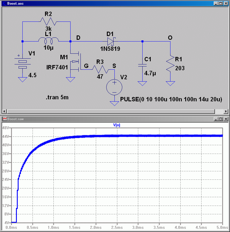

I need to make simple boost converter. 4.5V Input and 45V output. I need only about 10W output. Here is circuit:
I have clock source with duty cycle = 0.9
I don't know how to calculate L1, R1 and C1.
R2 is load and I choosed 203 Ohms (U=45V, P=10W then R=202.5).
It's not necessary to have 45V output, output can vary +-10V.
Can somebody help me? Excuse me for my bad english.

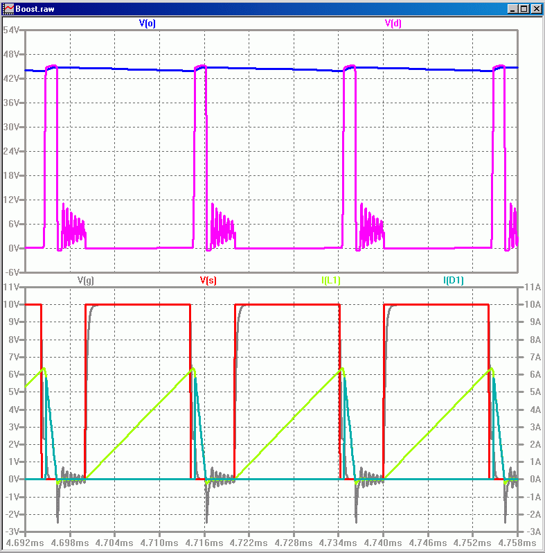

It is not as simple as you think!
1. The peak inductor current requirement is large. You will have a hard time to find a commercial inductor which supports ~6A without core saturation. Can your battery supply a peak current of 6A?
2. C1 must be much larger to filter the pulses, even though I raised the switching frequency to 50Khz. Note the gate drive duty cycle to get ~45V out.
3. The NFET drive requirements are critical: Gate Driver impedance MUST be very low (see the 47Ω (R3), otherwise the gate capacitance will slow the rise/fall time of the gate signal, slowing the FET switching times, causing HUGE dissipation in the FET. The amplitude of the gate drive must be sufficient to saturate the FET. Typical gate drive level is 10V. Logic-level FET might allow 5V gate drive; 4.5V will be marginal.
4. The power dissipation of the NFET is ~2W, so it will have to be heatsinked.

You will never get what you need with an air-core inductor. There are commercial inductors that can handle that amperage; I know digi-key sells some. I just bought some 24A inductors from them. At 10W that's only about 600ma output, so only about 6A input, with a peak of ~8.2A or so.
4.5 to 45v might be too much for a single stage boost. You might have to make it a double stage. This would also limit your peak currents through the inductors as well, reducing their requirements.
Is this a constant load? Boost converters without any feedback regulation require a load that never changes, otherwise they will blow themselves up.
