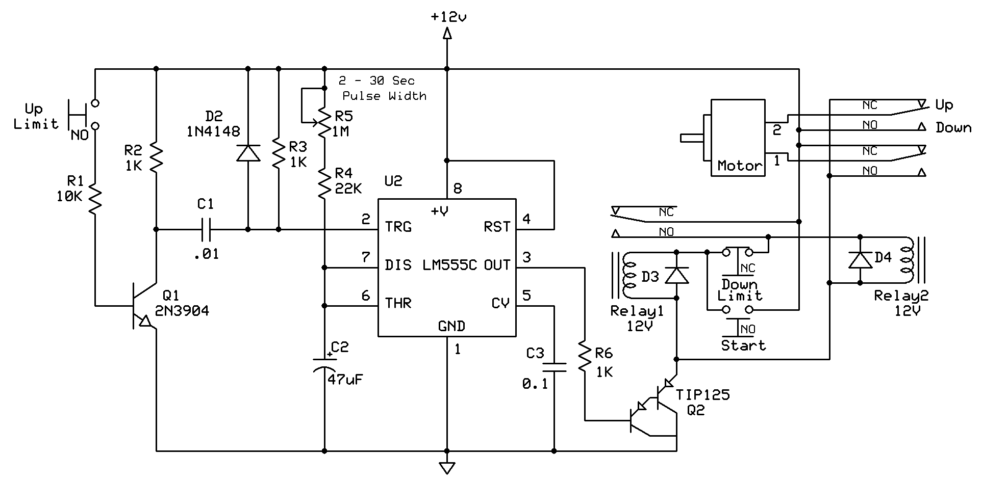

Hello,I know this question has probably been answered a hundred times but I'm having trouble finding a simple solution. I've designed an apparatus that uses a 12v dc motor to open and close a sliding door for our dog. I'm using a DPDT relay that reverses the motor when it reaches the end of it's stroke to then close the door. What I need though is a simple delay, around 10 to 20 seconds before the relay switches the motor to reverse. Thanks for your help in advance.

Ken,
thanks for this. I'm a mechanical engineer and have never made a circuit before but I'm eager to give it a try. In fact this little project of mine has got me so interested in electronics I'm thinking about going back to school. After spending a few weeks reading through this forum I have become fascinated with all of it.Two questions about this circuit, what is the delay? and what would I have to do to adjust the delay if necessary?
I appreciate your help.

The time delay is adjusted by the "potentiometer" R5 in my schematic. It's a variable resistor...like a volume control.
