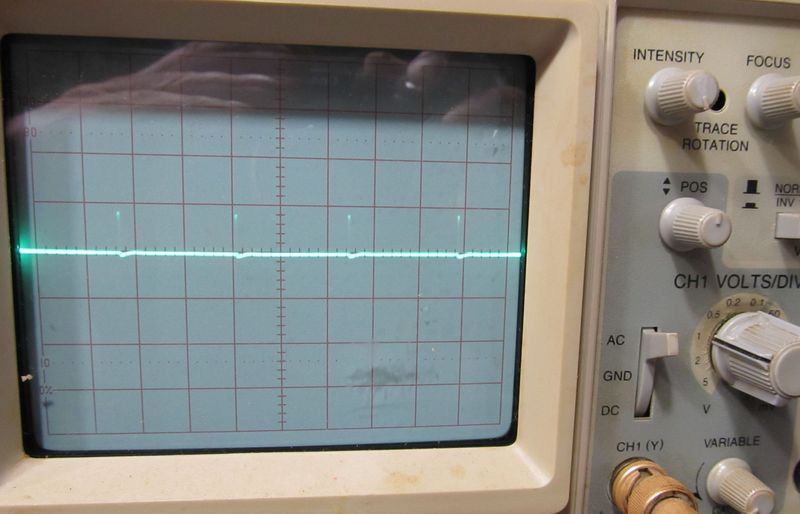

this is from the battery (scope/probe X1, 100mV/DIV : 20140308_004408.jpg 20140309_175217.jpg

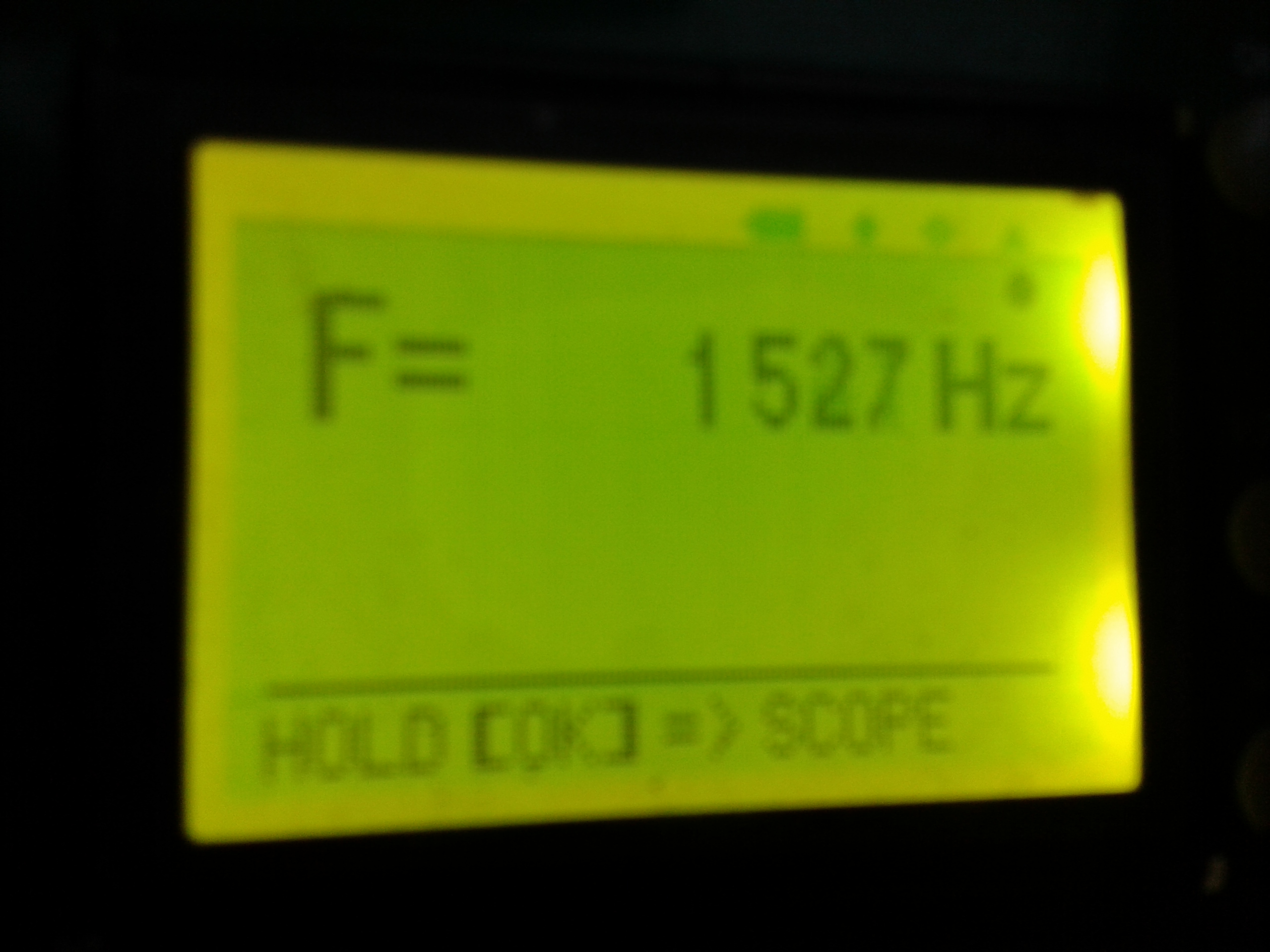

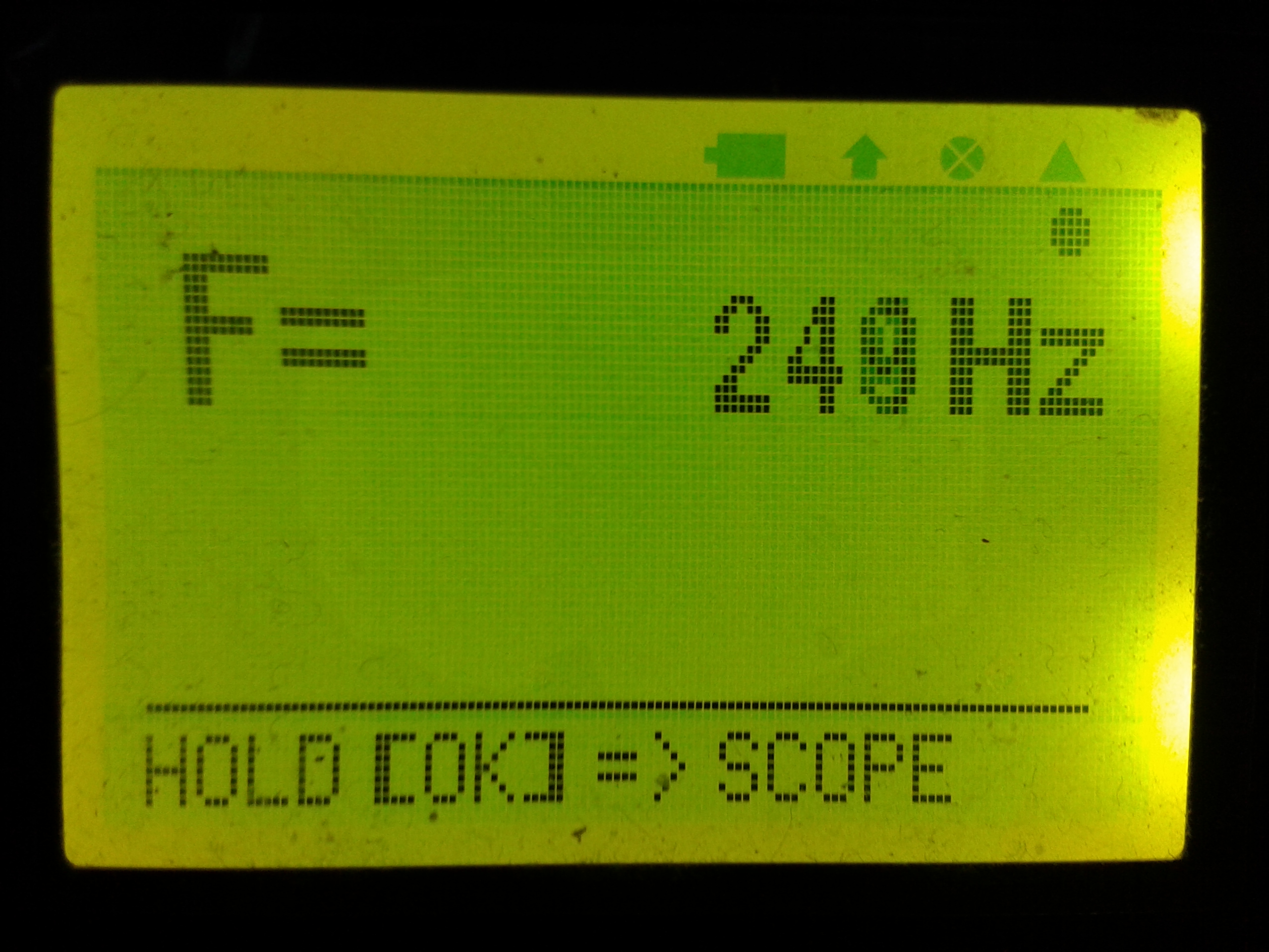

and this is from the pin #3 of the 555: 20140309_175010.jpg
as you can see the frequency constantly flactuates, it is never steady...

100mV/DIV
So, it goes up only 0.07V? And battery is 13V whithout load. These are signs of the battery being relatively healthy. 13V might be a little bit too high for the resting voltage, could be some stratification or low electrolyte. What kind of battery is that? Is it flooded? Does it have caps that you can open? If so, can you look inside at the electrolyte level (don't forget goggles)? Why don't you like it in the first place?

Unless your using Very Low Quality Caps or Resistors the Frequency should remain Quite Stable.

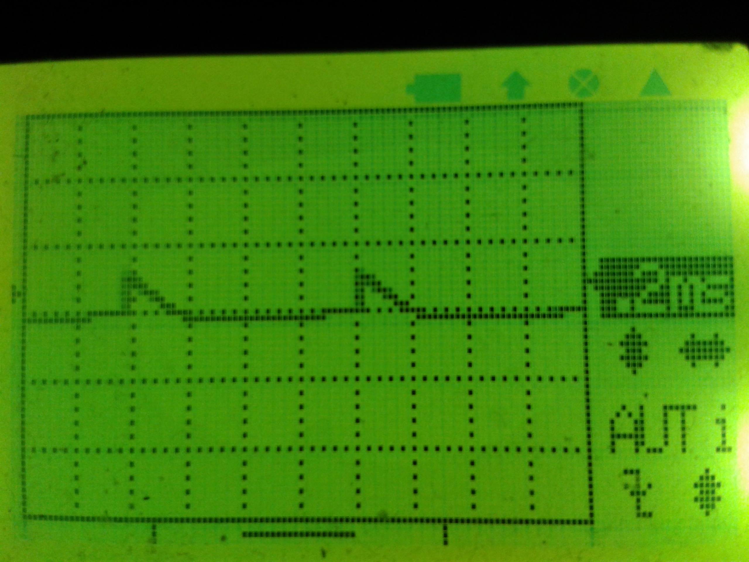

this is from the battery (scope/probe X1, 100mV/DIV : View attachment 84790 View attachment 84791
and this is from the pin #3 of the 555: View attachment 84792

Here is the Scope Picture of My Desulfator, On that SAME Sulfated Battery.
Notice how SHARP these Spike are on My Desulfator!
Also about 0.8 Volts, compared to 0.3.

yes i can see it...maybe it's my oscilloscope's issue? but still i don't get it...how 0.8V
can desulfate a battery?!

R1 471K, R2 22K, C1 2.4nF my spare parts seem to be exact...also awhile ago i charged
the battery again, now pin #3 is around 1.2KHz the fluctuation is 10-20 Hz, constantly
it goes up and down, it never remains steady, i could use these components instead
but i think nothing is going to change most likely it's the battery's voltage level
that changes the frequency..

As I Said before, The Frequency is NOT THAT IMPORTANT.
But the 1.2Khz sounds Correct for these values, compared to your Previous Frequency tests.

i found a dead battery from a car service, it was around 7v.. then i added
the desulfator and i probed the poles with the oscilloscope what i saw was
a huge pulse over 300mV i didn't had the chance to check the exact value
because after 25-30 seconds it falled close to 80mV
