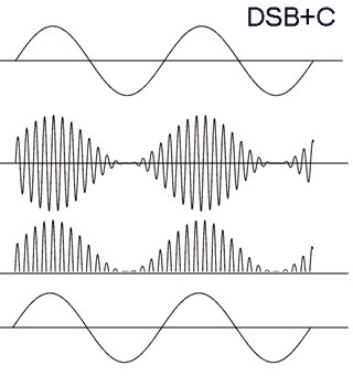

Dear EEET student,
The carrier is required in a diode (envelope) detector because the diode detector simply rectifies the incoming signal and eliminates the DC offset. Perhaps a diagram would help? The figure below shows a standard DSB+C modulation scheme. The top signal is the intelligence signal that we start with. Below that is the modulated signal, double sideband with carrier (DSB+C), i.e. standard AM. The third signal down is what the diode detector will do - it simply rectifies the input signal, chopping off the lower half. The final signal at the bottom is what it would look like filtered and DC offset eliminated. Note that it is our original signal back again.

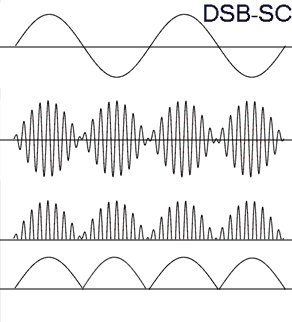

The other figure is the same intelligence signal, this time modulated using DSB-SC (supressed carrier). Along the same lines, my simulation shows what would happen if you demodulated using a diode detector again. Note that you get a full wave rectified version of the original signal! Hardly a satisfactory way of getting the original back.... Therefore, it should be obvious that the carrier is absolutely necessary to get back the original signal using an envelope detector!
