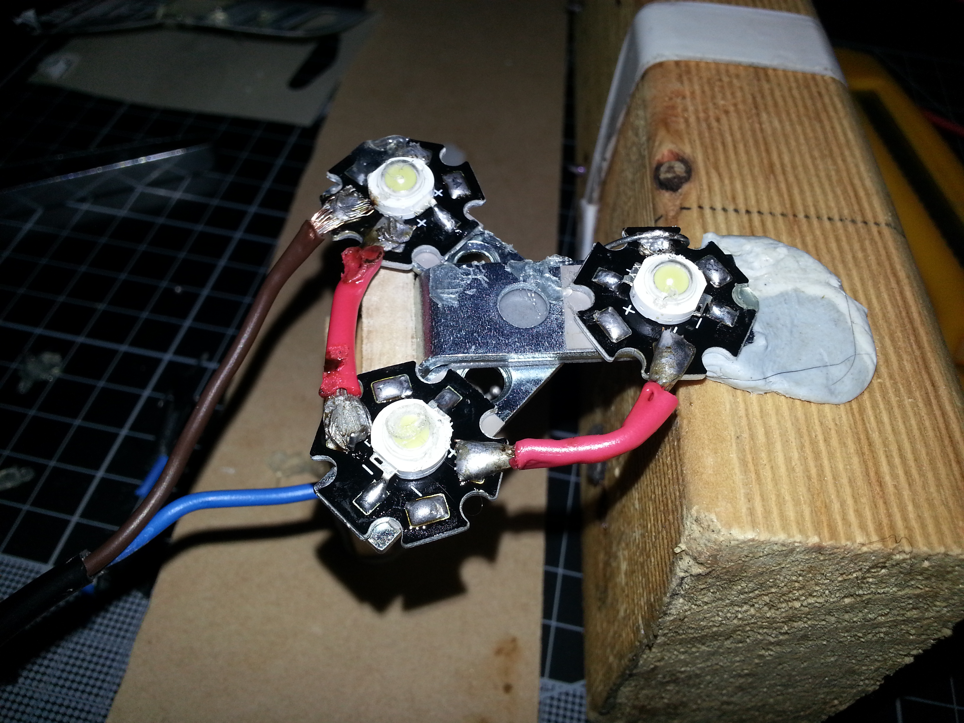

I'm looking for some information about a lamp I'm trying to make. It's incredibly simple, I've got an "LED Electronic Converter" (basically a power supply to convert the 240V to 12V), 3 High Power LED's (specifications at the end of the post), a 1W 1 ohm resistor, and some wires.
I've soldered everything together, and switched it on, and boy was it bright, blinded me for a while. But then the light started to flicker, so that was alright, figured it was just a bad solder joint (which you won't be surprised by when you see the photo below). So I went through and made sure that all of the solder joints were getting good contact with the LED star plate, and then switched it on again. This time it turned on, but the LEDs were incredibly..... dull. They were maybe around 10% of full brightness. So dull that I could actually look directly at the lights, and be able to see the wires and inspect everything.
So my question is, am I missing something? These are powerful LEDs, is my power supply insufficient? I really don't think it is, it's supposed to handle 2.5A, and the LEDs will be drawing around 700mA total, perhaps there isn't enough power draw?
Anyway, if someone could please point out what could possibly be going on here, that would be great.
Thanks.

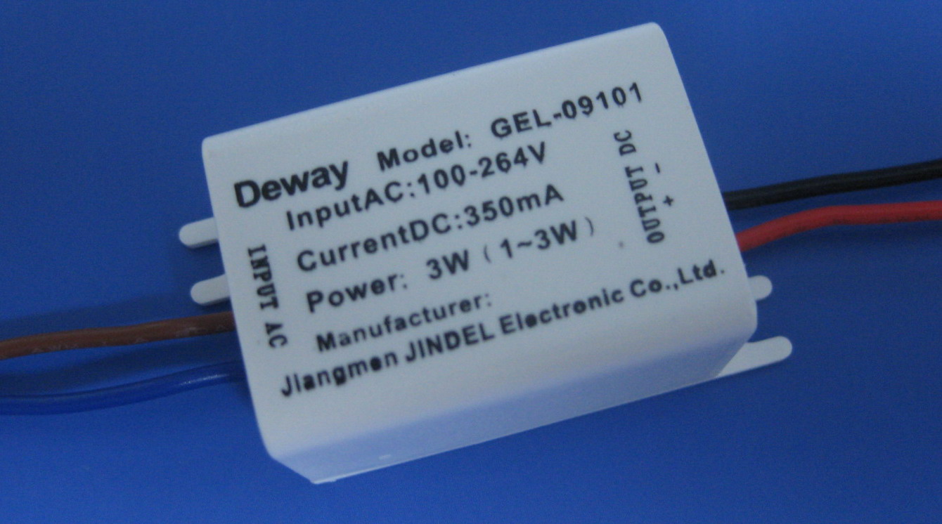

Power Supply Specs in attached image

I think that you have burned out the LEDS.
The Vf of the LEDs is 3.2 to 3.8v
Take the average of 3.5v, then three LEDs in series will drop 10.5v.
The PSU has an output of 12v, 12 - 10.5 = 2.5v. So 2.5 v has to be dropped across the 1 ohm resistor (and the wiring, say 0.5 Ohm)
Using a bit of Ohms law,
2.5v / 1.5 Ohm = 1.66 Amp flowing through the LEDs, maybe a bit much for LEDs rated at 0.7 Amp.
The situation will be worse if the Vf of the LEDs is on the low side of the specification, and the wiring resistance is less than the 0.5 Ohm I have guestimated..
Afterthoughts,
The LEDs are wired in series, aren't they? I it is a bit difficult to decide.
The heatsinking arrangements don't look that good. I am guessing that this lot got very hot.
I agree with JimB. The LEDs have fried :(.

I measured the output of the PSU with the LEDs connected, and it is a constant 12V. This was one of the first things I checked when the lights started to flicker.

You should be using a LED driver like this. No resister needed.
You're very right, however I had already purchased this PSU, so I'm hoping I can just get it to work. Future projects however, I will definitely be going for a current driver, instead of a voltage source

Even if the OP had used a constant current source, he still would have blown-up the LEDs. These are designed to be bolted to an aluminum heat-sink to get rid of the heat that they produce while running. If you run them with no heat sink, you will melt the LED.
Looks like he has them on some sort of a makeshift heat sink.
A 2x4? Here is what Wiki says about heat sinking high power leds:

As for the makeshift heatsink, that was kind of an accident. I just put it together that way because it fits into the lampshade that I have. I hadn't really taken any consideration of heat sinking, apart from using thermal tape to stick the LEDs to the metal brackets..

I think your LEDs are destroyed. I hope you replace them with name-brand ones, use a reasonable amount of current and use a suitable REAL heatsink.
The metal brackets are way too small to be a proper heatsink. You will need an aluminum heatsink with a surface area about 100 times more than what your photograph showed.
Next time, start with an old CPU cooler heatsink. Mount the LEDs on the smooth side. Run it for a while, and then measure the temperature rise. Based on the temperature rise and the max temperture limits on the LED data sheet, if your rise is smaller than allowed, you can make the heatsink surface area smaller. I.E. start big, and then work down to the smallest heat sink that will keep the LEDs at <~60deg C.
