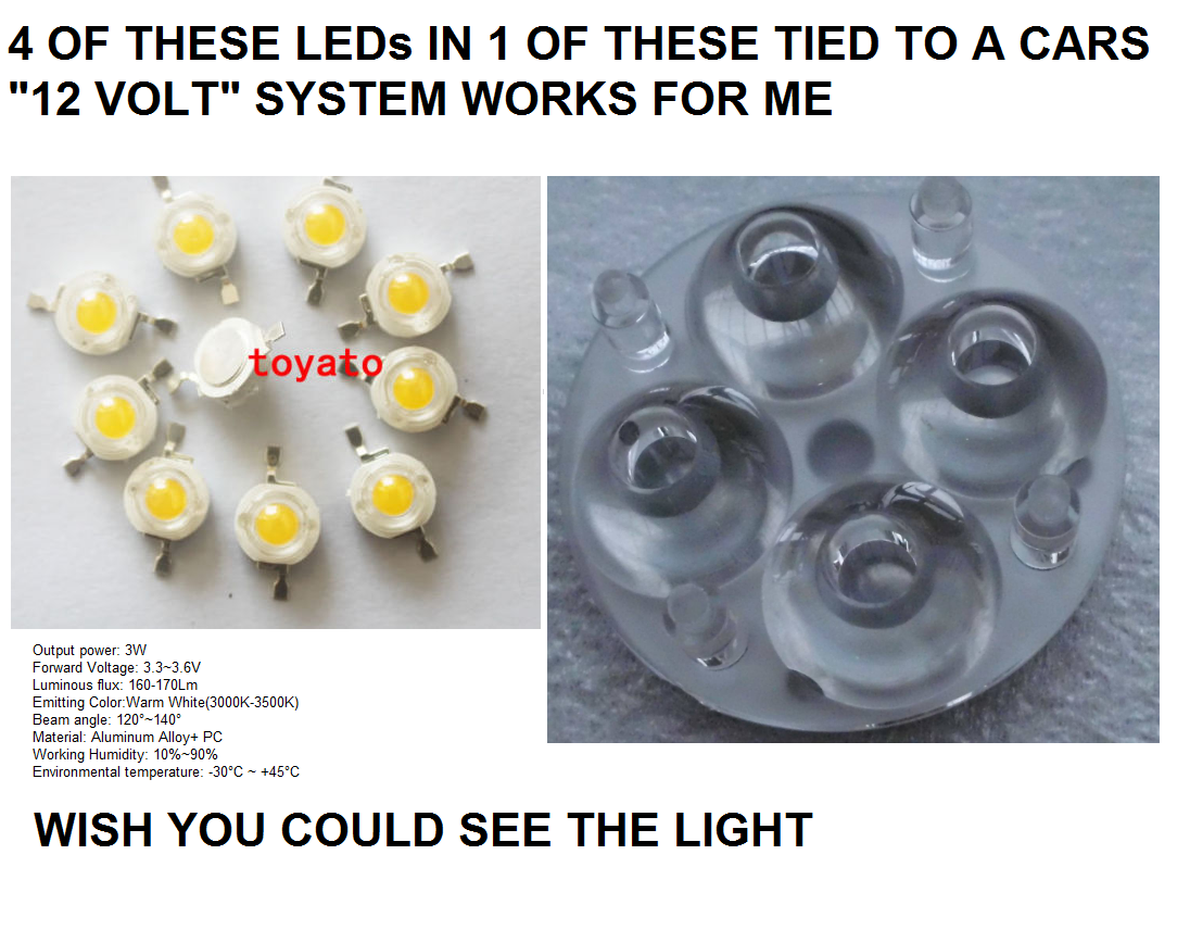

I know most people don't like the idea of using LEDs without a resistor, but since you have a 12 volt power supply, try 4 LEDs in series, no resistor and see if that gives you enough light for your project. I speak from experience, I have a light on my bench that is 4 in series, on a fan cooled heat sink and they have lasted for months so far, I also use the same set up on my off road vehicle, putting 6 string of 4 tied directly to battery power via a switch. Haven't burned an LED yet and I have run them for hours at a time.

Theory - each led is rated at 3 watts, for ~ 3.6 v, 4 X 3.6 v = 14.2v
Measured voltage of vehicle, 14.2v with engine running.
Minus losses in wires. Actually tests, current was less than max specs, 700 ma and way under with out engine running.

This is NOT luck. If you'll admit it, It's PROOF that you don't always need a limiting resistor!

If you had one blue or white LED, 3.0 - 3.5 volt powered by 2 1.5 batteries, what resistor would you use, do you see any resistors in these cheap 9 LED, 3 AAA battery flashlights.
Why is so hard to believe / accept that 4 bright white LED in series with no resistor won't work on a car?

Of course 4 LEDs can work in a car, but it is relying on a luck to work, and as such is poor design.
The current is not controlled, and the brightness varies a lot when the supply voltage changes due to the alternator running or not. It would only take a little more voltage variation for the LEDs to turn off completely or to blow. Variation of the LED voltage due to manufacturing differences or temperature will also add to the uncertainty in the current.
Admittedly high power white LEDs have quite a lot of internal resistance, which helps to stabilise the current, and that is probably why it works at all. However the current variation is too large for the design to be taken seriously, or to be recommended for others to try.
