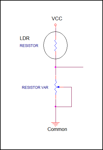

Regarding Ground. There is no ground implemented to any of the cables joining the circuit so do i just make a common ground from scratch? Therefore just joining up all unused terminals and things like the third leg of the pot together?
Regards
Alex
Everything marked (-) in the original drawing is ground or common. Everything on the VCC line marked (+) is VCC. Also, what I was getting at with the pot is attached to give you an idea. Hope that helps.
Ron
Arr Thanks for that.
So when using batteries you will always connect earth to the ' - ' terminal?
Regards
Alex
Yes, battery negative (-) terminal can be common, ground or earth depending on the naming conventions used.
