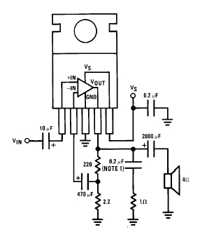

I built this design, from the page **broken link removed** under LM383 Power Amp. The schematic they provide is as follows:
I turn the thing on and it works, well at first. As I turn up the input the volume from the speaker increases... but suddenly I hit a point where there is a tiny bit of distortion; the sound goes right to hell and the thing heats up considerably, even AFTER I turn the volume back down!! I let it sit turned off till its nice and cool again and then it sounds fine, and the process repeats. The chip dosen't get warmer as I turn up the voume, it simply spikes with heat at that point in turning up the volume. I built my circuit to the schematic above, my actual physical construction is shown below. If anyone can see anything wrong with this, I would be most greatful for your help! If all else fails, those loud speakers are gunna get the LM386 treatment
-- but I would really like to feed them their 7 watt capacity to get some nicer sound for the Kiosk.
Once again thanks soo much in advance!
