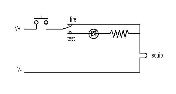

I was just basically after a simple (if possible) continuity tester that only requires a small current and voltage to flow through the object in question (in this case, Estes model rocketry ignitors). All that it needs to do is light up a LED when the circuit is complete. Power supply will be from the main circuit, which uses 4xAA 2000mAH NiMH batteries.
I would rather stay clear of using an LED with a resistor to limit the current through the test circuit.
Thanks in advance.
Edit: I should have said that by "simple" I mean a circuit that is the bare minimum to suit the use. I don't really need all of the bells-and-whistles that a few of the circuits I have found have. As long as its relatively small, and is able to indicate continuity using a low current.
Edit 2: Now with crappy sketch goodness:
This is just a rough sketch, as I do not have the design software on this computer at the moment.
I think you'd need to determine the amount of current that would give you an indication without firing the motor - then plan to stay well below that.
That is indeed the plan. Whilst at this point in time I am using Estes brand ignitors, in the future I may use another brand, which may or may not have a similar firing current. I have read and heard that other brands have a safe test current of 50mA or less. So, I suppose it would be wise (for future-proofing) to use a continuity circuit that can test with less than 50mA of current.
10 ma is sufficient to power a LED.
In the portion of the circuit that contains SW3, LED2 and R2 you also have a connection that is essentially across LED2 and R2 - so no current will flow thru LED2/R2. If you were to put a switch there and size LED2/R2 for 10 ma you'd be all set. Not sure if that's what you want.
LED2 and R2 are intended to indicate that the fire button is closed and current is flowing. LED2 should only really stay lit if there is a problem with the ignitor (e.g. a short). It should actually be removed because as it is, it will not function (don't ask me what I was thinking there), and the continuity circuit will eliminate that need anyway. If there is a problem with the ignitor, such as a short, it will be apparent when continuity checks OK (SW2 in "S" position, SW4 closed), but the ignitor doesn't fire when SW2 is in position "A" and SW3 is closed.
Then again, if I did just use LED2 and R2 (with the appropriate value), I could move it in between SW2's "S" position and the top of SW3, getting rid of SW4 and CONT. TEST altogether...
Obviously I forgot to try to KISS :p
Edit: The latter is probably the best way to go I think. If I used say a 155Ω resistor (trimpot for adjusting between alkaline or NiMH) for R2, LED2 should draw 20mA with 4x1.2V NiMH batteries correct?
I believe this is the circuit. I would use 340 ohms for 10mA and you don't need a trimpot. 10 mA is plenty to see the LED is lighted.
