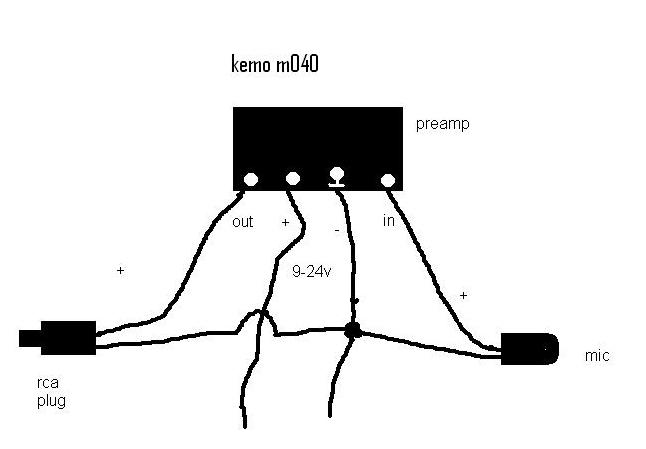

ok. i bought a preamp today from jaycar i have wired it all up but it's not working. when i use a 12vdc power supply it hums like crazy and if you tap the mic really hard you can hear the thump. i am using shielded cable. i thought the power supply might be causing interference so i then used a 9v battery and then there was no hum but if i hit the mic extremely hard i could here a faint thump. whats wrong ? below are amp specs and diagram of what i have done.
kemo m040 preamp
Specifications:
Operating voltage: 9...24 VDC
Frequency response: 10 Hz ... 100 kHz
Input: 2 - 50 mV
Output: 200 mV 1 V
Dimensions: 30 x 25 x 15 mm
mic specs:
Frequency response 20Hz - 16kHz- Sensitivity -65+/-3dB- Low Output Impedence- Directional Omni directional.- Size 30(L) excluding grommet x 13 (dia) mm

50mV in and 1V out is only a gain of 20 times, and 2 to 200mV is only a gain of 100 times - this looks far too low for a microphone preamp. I'm also confused why it gives different gain figures like that?.
What is the preamp specified as?, also what is the input impedance?.
As for the hum, it sounds like your 12V PSU probably isn't much good, was it just a cheap wallwart supply?.

You might have a look at this, **broken link removed** it's designed for use with 600 ohm microphones - the 47K input impedance of the pickup preamp if way too high, and it doesn't have a flat response (unless it's switchable).
I'll bet that your microphone type is electret, that needs power. Connect its "hot" wire to a 10K resistor. That junction will connect to the input of your amp. Connect the other end of the resistor to the + of a 9V battery and the - of the battery to the micrphone's shield.
