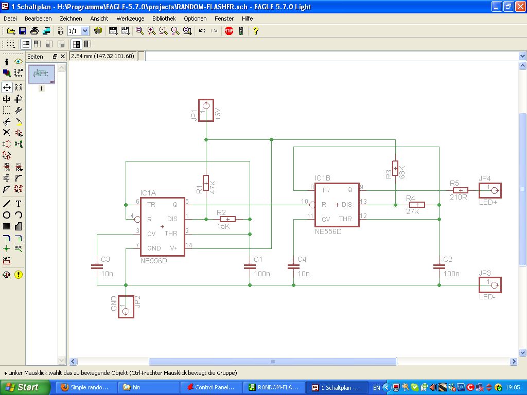

I need to put together a simple light-flasher circuit to simulate 'sparking/arcing' wires. Problem I have is space constraints - I have to fit all the circuitry, power-supply and switch into two volumes: a 60mmx3mm disc and a 10mmx10mm cube.
Basically it has to fit into the model and base below and is to represent trailing wires once an arm is ripped off. :) The lights would hang on wires out the arm socket.

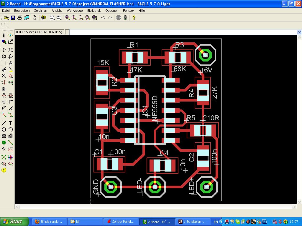

I thought about the two problems: random flash and space issues and came up with this idea:
Use a dual timer (NE556) and have the first one oscillate at a higher frequency than the second one. The frequency division ratio must not result in an integer value (e.g. 400/100).
The first timer resets the second one at its output frequency and the second timer is switched on only if the first timer's output goes high.
The circuit has neither been simulated nor been tested but should give a good sparking impression with the R and C values used.
The board should fit into the socket of the model you posted (0.65X0.8inches)
Regards
Boncuk
