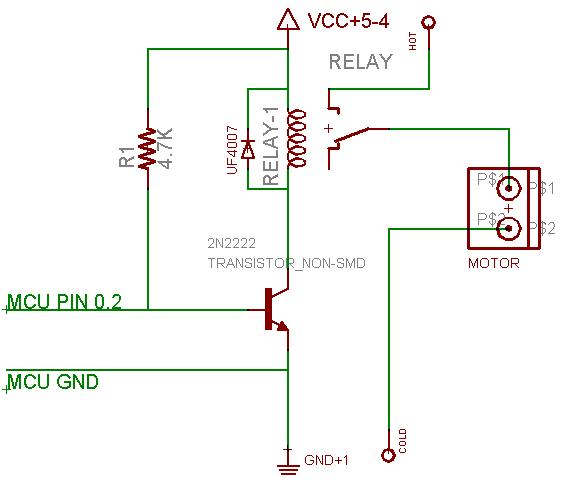

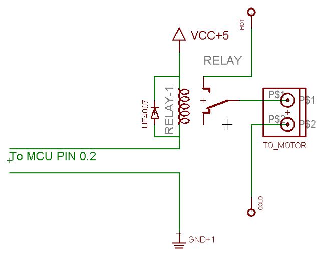

Simple relay circuit getting noise spike form AC line
Here is the Sch
Here is the sch...
have a look...

Improvement in sch

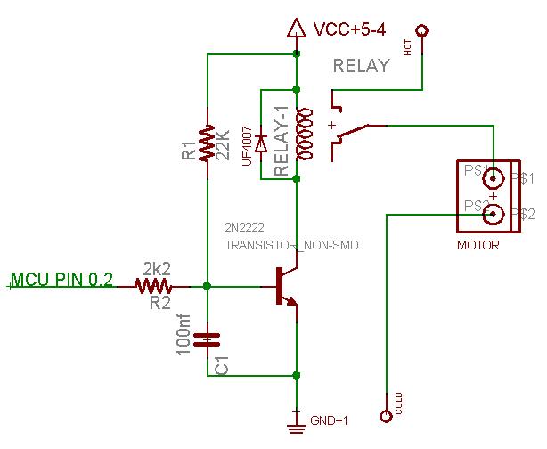

Thanks Colin,
I have made improvement in my circuit as u suggested.
But still I am having same problem.
Controller resets when relay changes its state.

1. Put a 2k2 on the base of the transistor and connect the other end to the output of the micro and 100n on the base of the transistor to 0v.
If the above doesn't work. Try the following:
2. Allow the relay to drive another relay that is 30cm away from the PC board.
Hi...
1. I have improved my circuit as u suggested. (So now it became as attached)
But it is still having same problem.
2. I have already tested what u have said in second point. it works nicely. but due to less space i cant palce relay so far from MCU.

Dear shripal
please do the following
1) please connect the 100 capacitor between collector and ground (emitter) of the switching transistor
2) bypass rf at the base with a 1nf capacitor as 100nf is too big for the purpose.
3) Also bypass motor power supply with LC pie filter.
