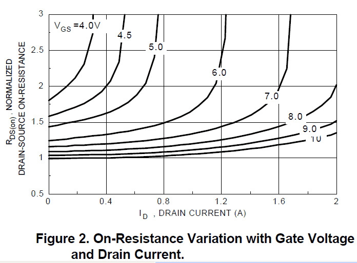

MosFets don't have a linear region. Take a look at the attached graph of a BS170
2. Maximize VGS in order to minimize VDS and RDS?
3. Do the larger the VGS is, the smaller RDS is?
2. and 3. contain the same question.
The higher VGS the lower is RDS(ON), hence ID increases. Again refer to the graph.
Boncuk
