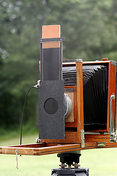

I use it to operate solenoids for the shutters of an ancient camera to make it usable for high speed films.
